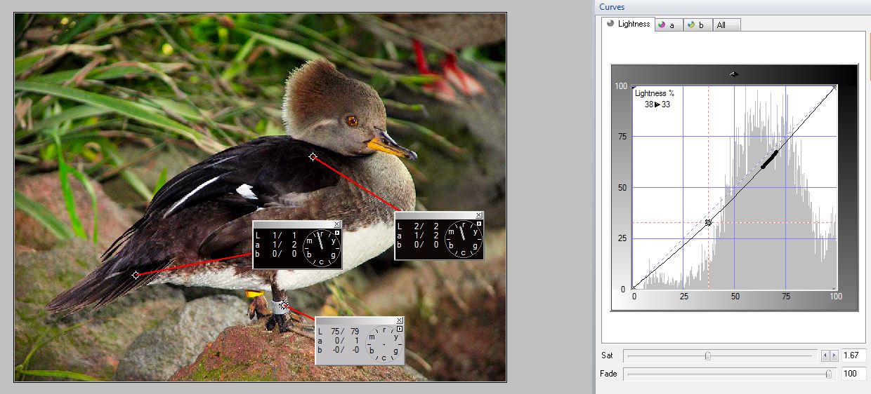

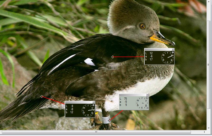

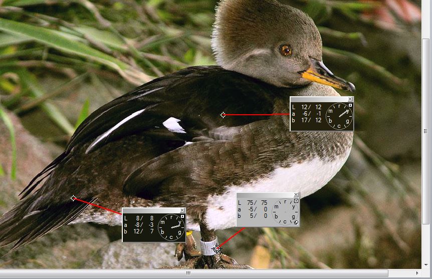

Postby ggroess » Tue Sep 03, 2013 12:50 am
Tina,
RE: LAB Duck.
In Lab the neutral is critical.  Lab can be fast and furious color but you have to nail the neutral otherwise the entire image suffers a bit for it.  In your case the image is a bit too greenish...Almost a cyan cast.  See shot 1.
To fix it set a neutral on the leg band as shown in shot 2 and move it around until you are satisfied with the tone.
In shot 3 I added some minor contrast adjustments in the L channel and I boosted the color a bit using the saturation slider.  LAB is famous for having the saturation fall flat after tonal adjustments...it's a math problem for the color space...

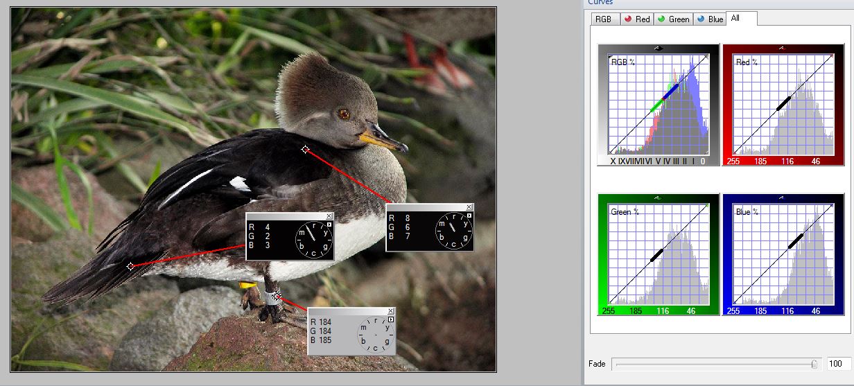

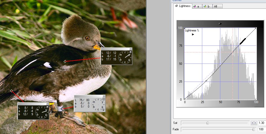

Re: RGB Duck
Overall the RGB image is in a better place which is expected since you are probably most familiar with RGB as a color space.  Shot 2 is your duck with hue clocks to show you that the RGB duck has better color overall compared to the LAB duck.
Shot1 is your RGB duck with a second pass into CM with a slight tonality correction and a saturation boost.  It really makes a big difference...

tmanley
Posts: 67
Postby tmanley » Tue Sep 03, 2013 1:17 pm
Thanks, I can see that now, especially in the brightness of the duck's eye.  Your's is much better.
