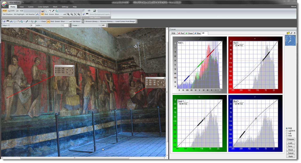

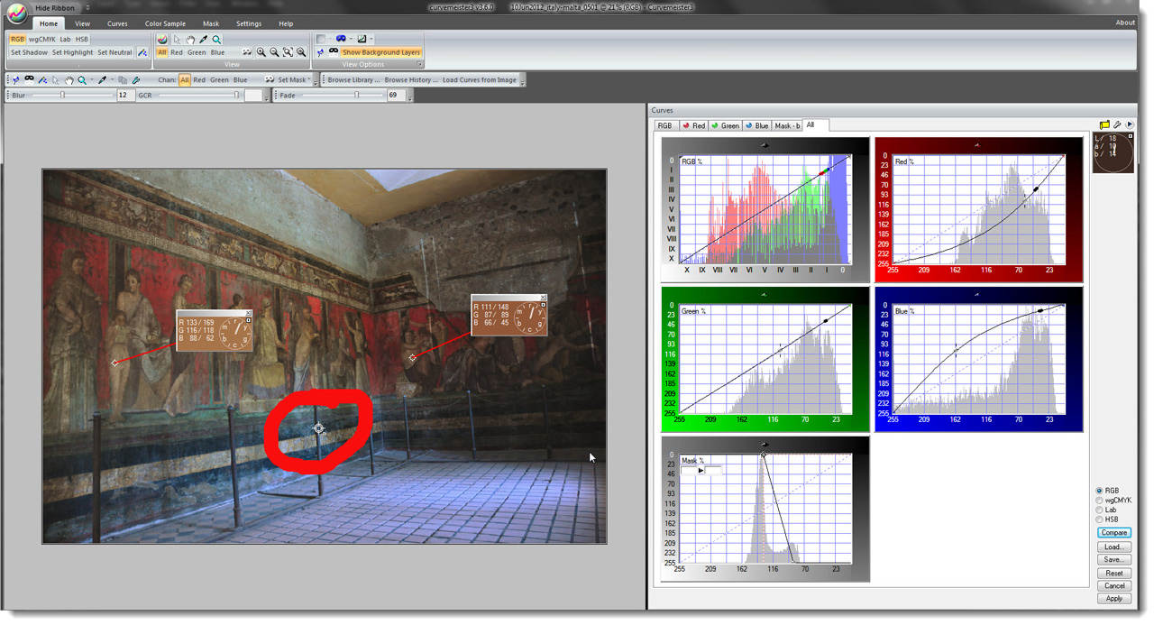

Shot 1) knowing that this was a mixed lighting situation I knew I would be masking and made no attempt to fix the bottom half of the frame. I found a small piece of concrete patch in the back wall that was newer than the old wall and set my neutral on it. I set two skin tone hue clocks to check to see if I was in a good spot for the neutral assuming that I had reasonable skin tones on the wall since I did not shoot the image...

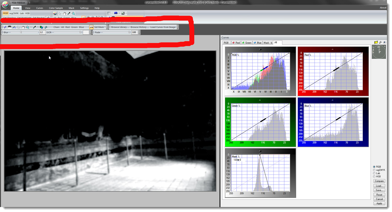

Shot 2) I created a mask from the b channel of LAB and using the NEW blur slider...I blurred the mask as shown.
Shot 3) Then I found a small paint patch on the pipe that I made the assumption was black and set a neutral there. Since the effect was pretty large I used the NEW Fade slider to soften the effect and keep some of the original color in the image...
More in the next posting....
Since no one excepted the challenge I will finally post my version.
My correction is unconventional because I am going to sneak peek some up coming changes to the CM interface that we think you all will like very much!
THE VERSION OF CM I AM RUNNING IS A BETA BUILD AND THE FINAL FEATURES MAY LOOK DIFFERENT !!!!
Ok having said that here is what I did...
- shot-1-jpg (159.56 KiB) Viewed 29144 times
- shot-2-jpg (298.21 KiB) Viewed 29144 times
- shot-3-jpg (301.67 KiB) Viewed 29144 times

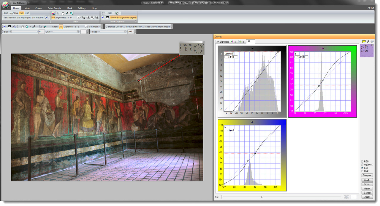

Now for step 4 LAB Color:
Shot 4 shows the LAB curves I added to the image to make the following corrections...
a) I re-thresholded the image to adjust the brightness a bit
b) I added color variation to the b channel to make the yellows in the clothing on the wall pop out a bit more and to green up the boarder around the images that glows a bit. I also added a bit more yellow to the floor with this...
c) added some color variation to the a channel in LAB to help the greens even more and to make the floor less magenta.
All that said, I think the actual color of the floor tile is behind the barrier somewhat and the main part of the floor can handle the blueish tint so long as it is not overpowering the rest of the image. My initial pass at this was a dismal failure because I only look at it for a few seconds before diving in...When I took the time I needed and made good choices I was able to bring out a lot of subtle variations in some of the colors and restore the original colors to the scene...
