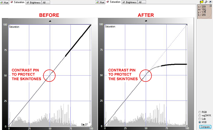

One of the benefits that Curvemeister has over Photoshop is the ability to create curves in the HSB color mode (Photoshop only has RGB, CMYK and Lab). Each of these color modes have advantages in particular situations (you'll learn more about this over the next few weeks); in approaching this image, I decided that HSB would be the best way to correct this photograph.
Greg mentioned that the client was unhappy with the background, but that the rest of the image was ok. The principle issue with the background is that it is too vivid; therefore the saturation of the background needs to be reduced.

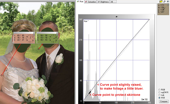

Selecting the 'HSB' radio button to the bottom-right of the curve window switches us into the HSB color mode. Now we need to find where we need to make our adjustments.
To find and mark the region of the curve that will effect the background, right-click the background (over the grass) and select 'Mark' from the context menu.
To find and lock the region of the curve that will effect the skintone (preventing it from being adjusted), right-click on the skin and select 'Contrast Pin'; the contrast pins added (again, you'll learn this during the course) will keep the skintones safe during the saturation adjustment.
To adjust the region of the curve that will effect the background - reducing the saturation of the background - I pulled the top-right end-point of the Saturation curve downwards (again, see BT_LH_Step-1.jpg - attached).
Having improved the saturation of the background, I decided that the foliage was too yellow (for my own taste). This correction is a matter of personal taste, and you may decide that you don't want to make this adjustment. My own point-of-view is that yellow is a very aggressive color - a color that subconsciously attracts attention - by reducing the amount of yellow in the foliage, we can make them less dominant visually. Therefore, my process was:
the Hue curve this time) the skintones and foliage were. If you look at BT_LH_Step-2.jpg (attached) you will see (towards the left of the curve window) two large gray spikes. These spikes show us where the skintones and foliage are on the curve. How did I know this? Right-click on (in turn) an area of skintone and an area of foliage. Select 'Quick Pin' from the context menu to add a point to the curve at the appropriate location.
Leave the point corresponding to the skintone color alone.
Slightly raise the point corresponding to the foliage, to move that color away from yellow and towards blue. Again, the degree to which you will move this point is governed by personal taste.
In addition to the two screenshots that show my curve adjustments, I have also attached my version of the image (after adjustment) and a side-by-side before/after comparison, so that you can see how much I altered the image.
I hope that my explanations made sense! If you have any questions please let me know...
- Find the region of the curve that will effect the background - mark this region for later.
- Find the region of the curve that will effect the skintone - prevent it from moving.
- Adjust the region of the curve that will effect the background - reducing the saturation of the background.
- Again, I needed to find out where on the curve (

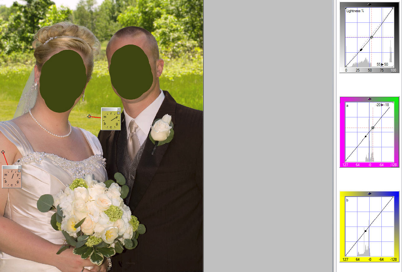

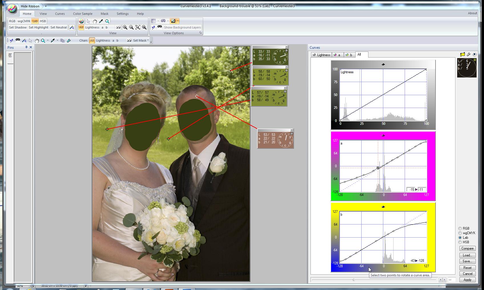

I found this quite difficult to do.
Used lab
I tried cloning the background to eliminate all the bright sky and lighter leaves and it seemed to focus the attention back on the couple.
I did not leave this done as I am a really lousy cloner, but someone else may like to try this.
Looking forward to the feed back
Used lab
- wedding-lab-1-jpg (219.31 KiB) Viewed 33471 times
- lab-2-jpg (220.82 KiB) Viewed 33471 times
- background-trouble-jpg (284.14 KiB) Viewed 33471 times
Hi Julie,
I think that you are using more Hue Clocks than you need to for the foliage. The angle of the hue clocks on the grass/leaves are pretty much identical - therefore, a single hue clock will give you all the information you need. In thinking about where the viewer's eye is being led through the picture, a hue clock on the grass between the happy couple will be fine...
As for cloning the background to eliminate the sky, the question isn't so much how difficult the cloning is, but rather would doing so improve the image's composition? Try temporarily cropping out the sky; to my eye, if the top of the image is only foliage the image's depth is compressed, and the sense of receding space is compromised. For this reason, my personal opinion is that the sky needs to remain within the image - although others may disagree...
I think that you've done a nice job reducing the saturation of the background. As previously stated, I prefer it a little bluer, but again these are matters of taste so it's not wrong to leave the hue of the foliage where you have.

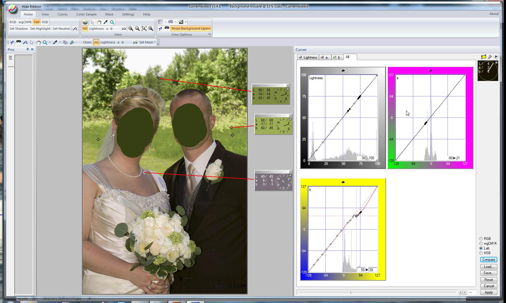

Well the first image I found difficult for a starter. I felt like I had been thrown in at the deep of the pool and did a lot of splashing around.
Greg, is it possible to give us a hint of where in the Manual, Help or tutorials to find some info that would get us going in the right direction.
I resisted the tempation to look at the other posts because I needed to work it out for myself.
Here is what I did:
1. I used Lab because the a channel is green/magenta.
2. Need to very careful because of skin tones and the green in the bride’s bouquet.
3. Set a Hue Clock on bride’s upper arm and another and the light coloured grass.
4. I worked a channel carefully and then a very slight change in the L channel.
My adjustments were very slight because I was feeling my way.

Here is what I did:
Di

Hello Di,
Sorry about the deep end of the pool we will do our best to make this easy...
The reason for the difficulty is to tempt the more experienced users to participate and share some knowledge. I know it is overwhelming at times but I assure you that by the end of the class we will be able to tackle this image easily. Trouble is this is a fairly common issue and one which CM can tackle.
The help files might not actually help that much for this since it is technique driven. One thing you could look at is the masks. My solution will be coming out later today. While it is not the definitive answer it will show another way to tackle this image.

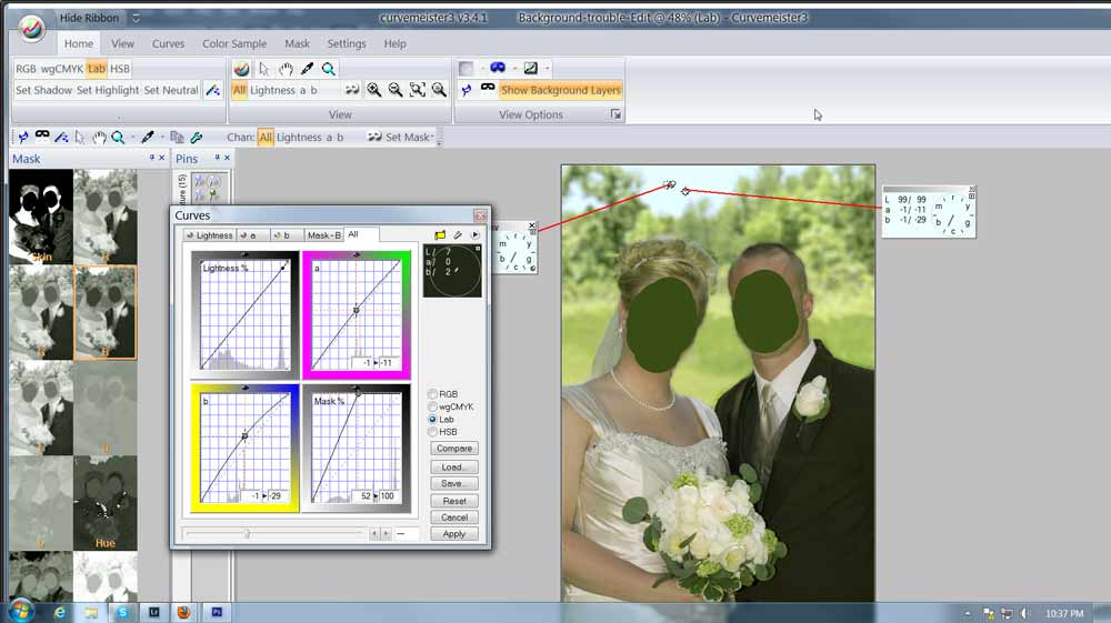

Here is a link to a short video about how I solved this troublesome background.
This is by no means the definitive answer but it does show off a bit of the Curvemeister tools for you.
http://youtu.be/jJyGzXmEwb4
Further discussion is highly encouraged...
