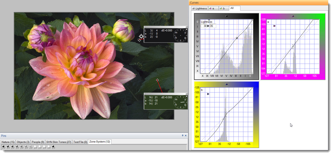

Postby ggroess » Wed Jan 18, 2012 2:37 am
OK for those waiting for a full LAB correction here you go.
If you have never experienced LAB before you need to know a few things.  LAB is considered a perceptual color space.  This means that you work with LAB much the same way you perceive color.  The LAB color space is divided into three channels.  L for Luminance, A channel is the red green Axis of the colors and B is the Yellow Blue Axis.
The Strength of LAB is the separation of brightness from color.  In RGB color if you change the brightness of one channel you create a color cast.  In LAB you can adjust the contrast and brightness without effecting the color.  A very powerful tool indeed...
LAB also has a wider color gamut than RGB this means that you can create more color in LAB than you can in RGB.  This is both positive and negative.  Positive in that you can really make images pop in LAB space.  Negative in that you can create colors in LAB that cannot be printed in RGB or CMYK colors.  This gets technical real fast but the bottom line is that LAB is a powerful and fast color space to adjust the images in.
Try out the lab space and go slow...a little change goes a long ways.
