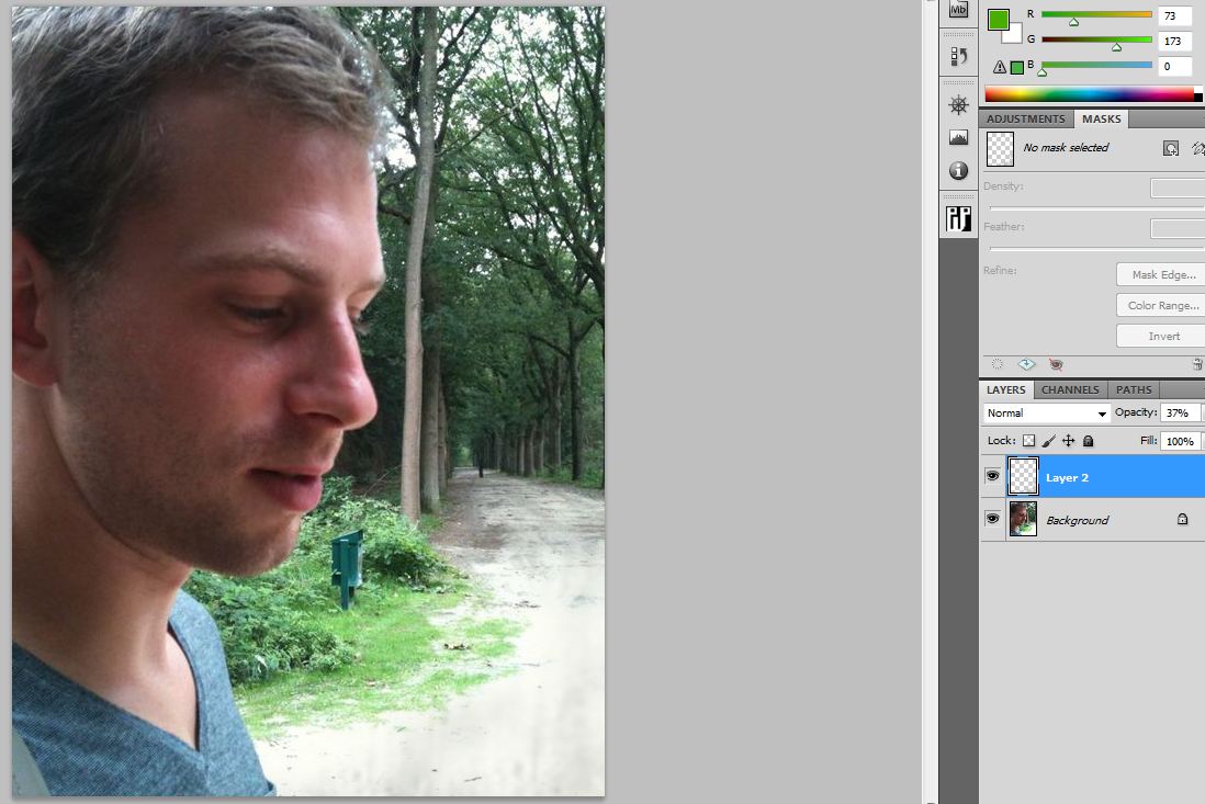

In shot 1: I show the image with the road cloned into a separate layer.  I copied a section of the road and pasted it into a new layer.  I used the "Skew" command to stretch the copied area out over the blown area and then set the layer opacity to 65%.  I then used a eraser tool with a soft brush to erase out the areas of the copied layer that covered the green spots near the middle.

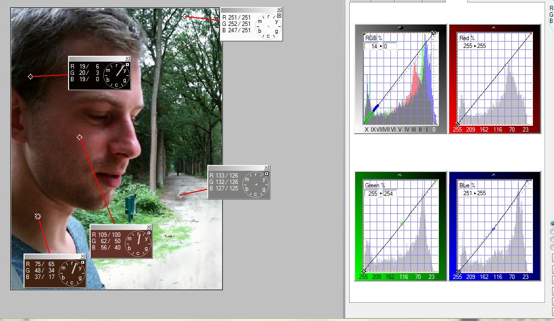

In Shot 2: I flattened the layers and opened the image in Curvemeister to do a RGB correction using the highlights in the trees I found a spot that I thought should be white and corrected the highlights to that spot.  I picked a mid-tone spot and corrected in RGB to make that neutral.  I picked a spot in the hairline to check the shadows and found the hair to be blue.  I corrected the hairline spot to be in the skin tone range but very dark so that the man does not have blue hair.

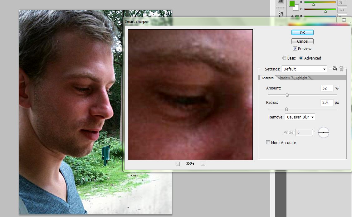

In Shot 3: I applied smart sharpen as shown with the settings you see in the screen shot.
