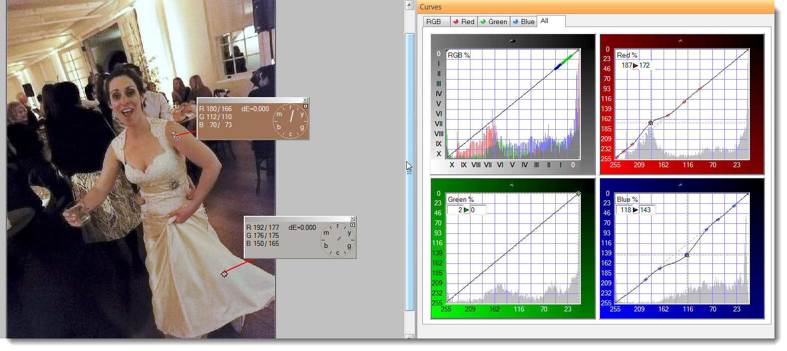

I downloaded your image and applied the RGB curve shown...It's not perfect but it is better...the majority of the curve points are to hold the adjustment into the middle tones...Leaving the shadows and highlights alone helps with this image...
I have attached the ACV file so you can load the curve in Curvemeister...save the file to your desktop, open your image in CM and click the load button...
