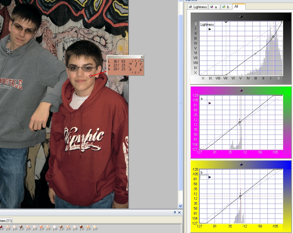

I Used LAB to set a neutral on the Gray undershirt of the taller boy. I then set a highlight threshold by moving the light end of the L channel closer to the center of the Curve grid. To open the shadows I dropped the curve line a bit in the upper right hand side. this opens the shadows but leaves the highlights alone. When I did this the mid-tones take a slight beating so I propped them up with the middle adjustment point. I finished with a slight saturation slider adjustment to bring back the colors that are reduced by brightening the image in LAB.

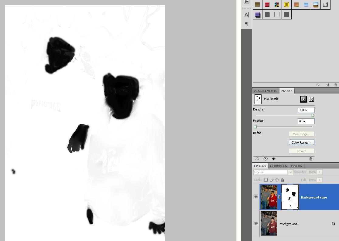

2. Shot2
I Created a "Skin" mask in Curvemeister by using the "skin channel" that is a part of CM. This is a created channel that the program makes based on the general range of the skin tones. I adjusted the skin channel mask to make the skin as black as possible so that when I saturation boosted the image I would not make a mess out of the skin. I copied the skin mask to a new layer in PS and then I painted out all of the black on the mask except the hands and faces.

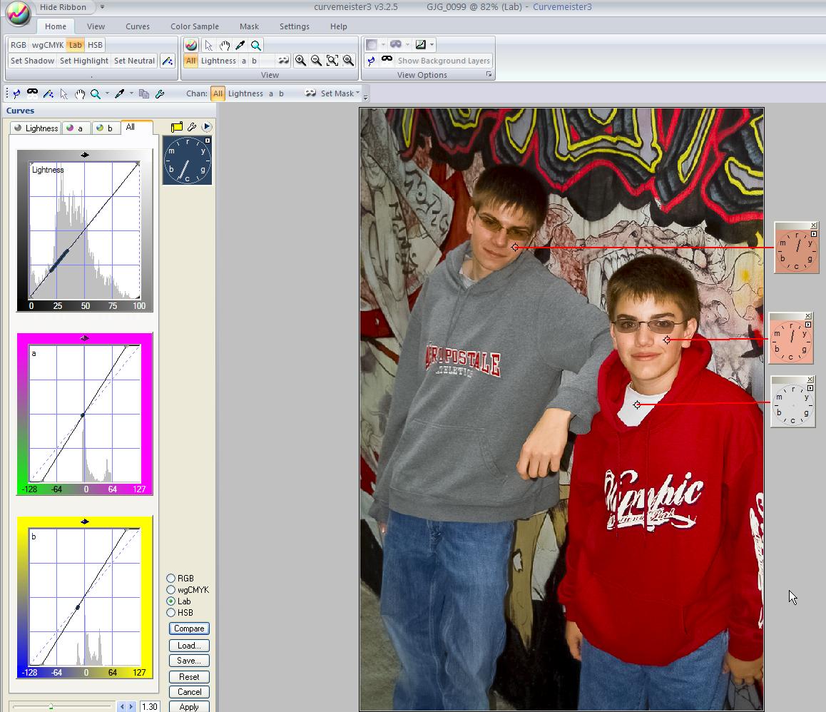

I decided I wanted to open the darker parts of the image like Thomas did.
2. Shot2

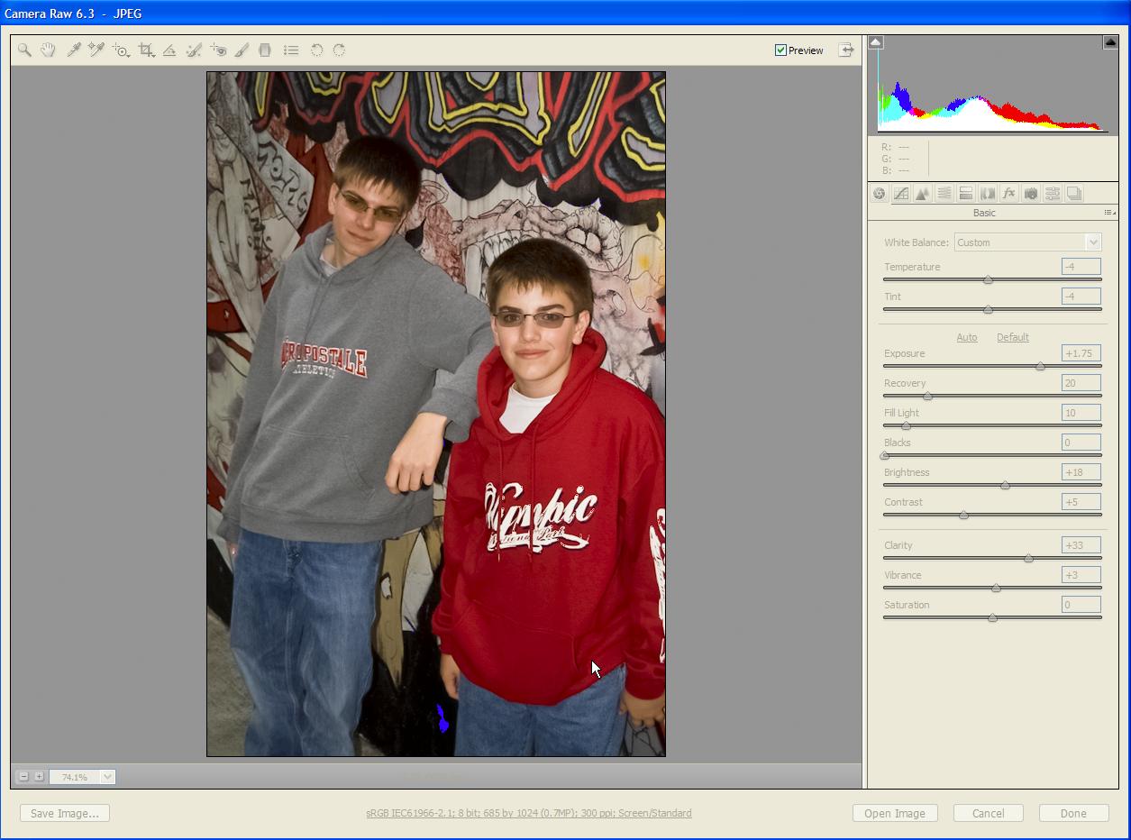

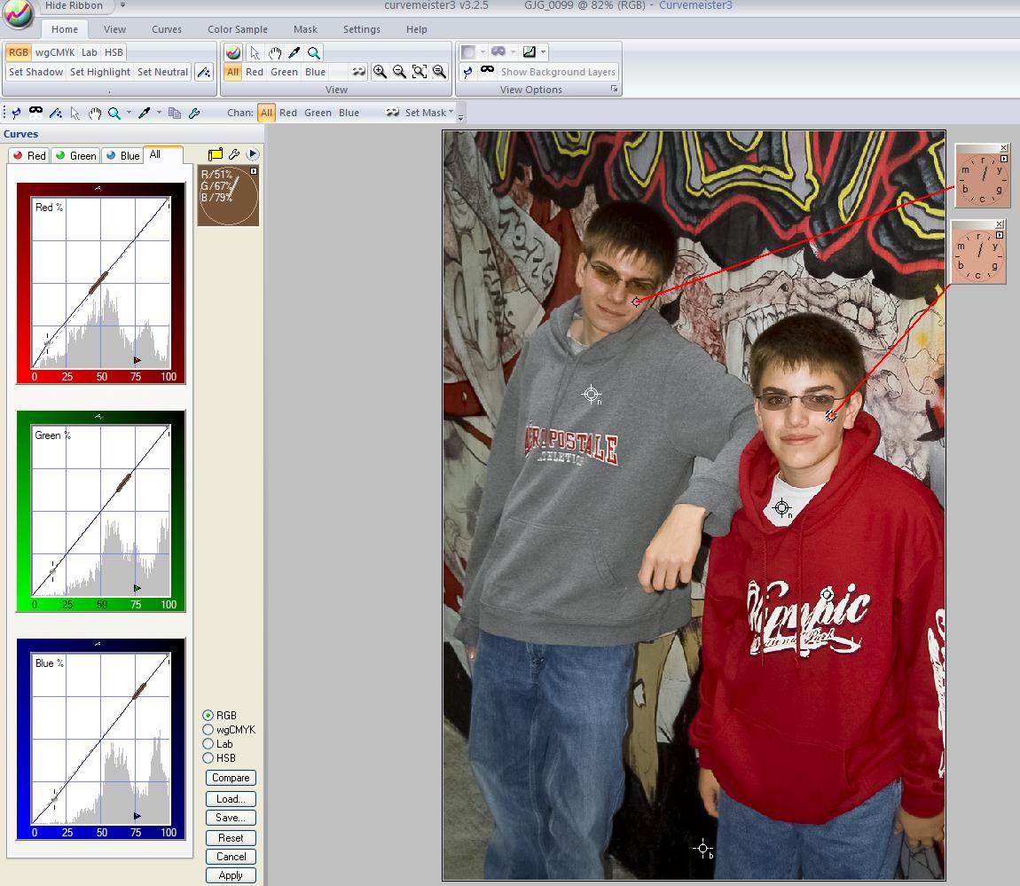

Hello
The image posted was corrected with CM using the Color Wizard. I played around with different black and white points. I used RGB. I plan on experimenting with LAB. In general, is there a rule for when to use RGB vs LAB?
It seems some of the other people are using some of the more sophisticated features of CM such as CM masks and skin masks. I assume the class will get into how to this starting next week. Is this correct?
Thank you
David Krassen
Thank you
David Krassen
- 20101208_gjg_0099_cmwizard-jpg (264.65 KiB) Viewed 15248 times
