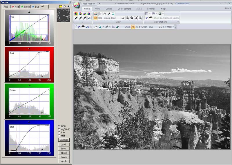

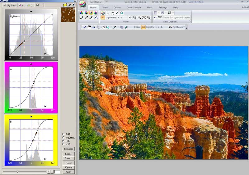

Hi there. Here's my attempt :)
1. I first separate the colours in LAB so that it shows better in B&W (Screenshot 1)
2.In RGB mode (with Mikes' B&W attachment for CM) played around with the curves for better separation and contrast
3. Sharpened and resized
I hope to learn about B&W images here, as I'm not so sure what the requirements are

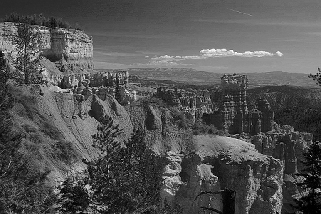

test.I can't come up with an image resizing that keeps the sharpness when you click on it.I first sank the red channel in RGB,thendrained the saturation in levels,then some work on the clouds and the last ridgeline in Brightness in
hsb.I would like the billows of the cloud to be as white as a puff of white smoke from a steam locomotive,the whitest point in the image.GregM

Greg is some of the artifact on the image color channel noise??
The sky looks suspect, I know mine is...I also note that the darkest shadows in my image are blocked up on the web. This will make it difficult to show off the real images...

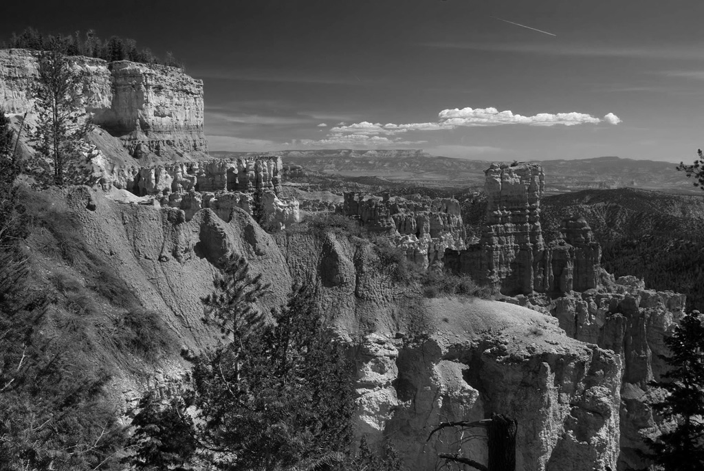

For this image I tried something a bit different...
I took the original image and I opened it in PS. I then switched to channels in RGB and used the "split channel" command to make 3 separate images out of the original. One B&W image of each channel. This will close the original image but you can re-open it in PS.
I re-opened the original image in PS and using CM I created a mask using Skin Tone as the source for the mask. This actually gave me a satisfactory mask for the sky to the orange rocks transition. I blurred the mask lightly using the CM mask command "Light Blur" This helped the transitions a bit between the sky and the ground. I then made a background copy of the red channel image, added a mask layer to it and pasted the skin tone mask into it. I then painted out any foreground so that my adjustments went right to the sky and far background. I adjusted the layer copy in CM to make the sky dramatic. I then applied the mask to the layer so that the foreground was removed and only the sky was left.
I moved on to the Green channel where I tried to get the most out of the middle tones in the image by making a contrast adjustment using CM to increase the overall contrast in the green channel image. I then copied the red layer image with the mask applied to it and pasted it as a layer to the green image.
I then moved onto the Blue channel where I found a mess...but I decided I needed some of the details from the highlights of this channel in the brightest areas of the combined red and green image.
I went back to the RGB image and re-did the skin mask using CM, only I inverted it so the sky was protected and the foreground was exposed to the adjustment. This time I copied the background of the blue channel and pasted the mask as onto the copy layer. I then adjusted the blue channel in CM to bring out the highlight details I wanted without adding too much tonality to the brighter areas. I applied the mask again so that only the foreground was in the image. I copied this layer and pasted it into the green image as a new layer. I then adjusted the opacity of each layer until I was satisifed with the results.
I know there is more but I wanted to make the correction in a reasonable amount of time. I then sharpened using un-sharp mask. This is by no means the definitive solution to the image. This is simply one possible path to follow.

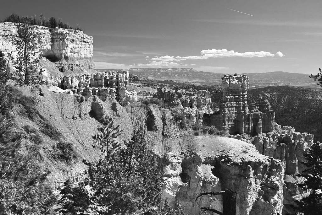

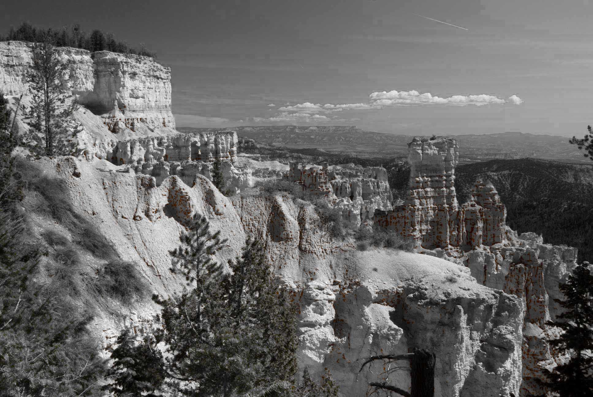

I've made two attempts:
1. This is in HSB, leaving Hue unchanged; Saturation at 100>0; and Brightness tweaked (two points: 75>78 and 25>22 - a shallow S-curve). It has some residual orange/brown pixels which disappeared in one attempt (which I've lost), but I've failed to eliminate them here.
2. This used the Adobe Photoshop Elements process: Enhance>Convert to Black and White. . .

Richard,
Welcome to the class...I am really curious about the freckles...do you remember how you did that?? Was the HSB conversion in Curvemeister?? again just curious..
The second one does look better overall. Is there a way in PSE to work on the Sky?? I have never used PSE for b&w conversion...time to open up the program I guess...
