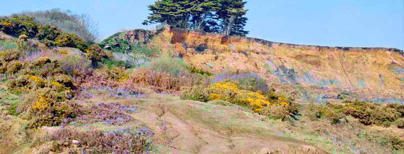

A simple ROC filter at default settings, then a slight contrast increase. I used the original picture that's just above this post.
Barton on Sea...
Since I don't know what this scene actually looked like, I thought I'd adjust the yellow slider in the ROC filter to give a warmer picture. I used the original unaltered pictured (Barton original) that was posted, then used the ROC filter and slid the yellow/blue slider to a -5.

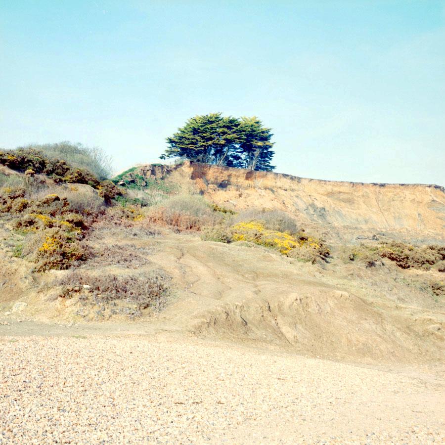

I'm back... Thanks to all who have participated in this exercise - it has been really interesting - and very helpful - for me to see (and compare) everyone's corrections; my student will be extremely excited to see how you have all improved her image!
One of the aspects that make this image interesting to me is that it was shot on Kodak Portra film. I initially thought that the photographer's choice of film stock ought to be respected - hence the link in my original post to the Flickr Portra group... Offline discussion with Greg has been rattling round my head for a week or so, and I'm now of the opinion that the film stock was not deliberately selected (her photography tutor gave her some free film), and therefore the image might benefit from a correction that doesn't aim too exactly at the 'Portra look'. I know that this contradicts what I've previously said about the image ::)
I will ask the photographer what she prefers...

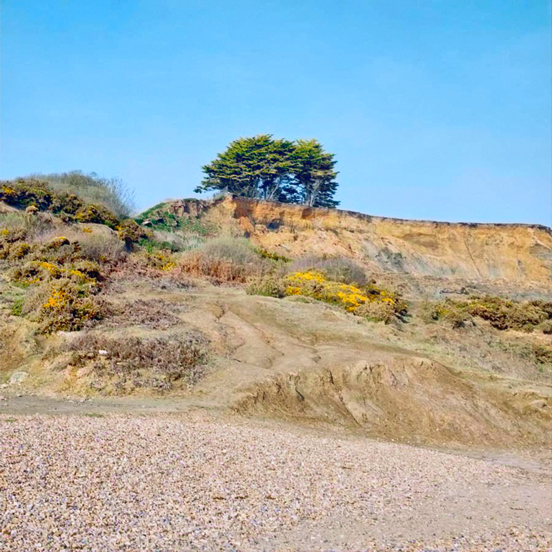

In evaluating everyones' corrections I have been playing with some recent advice on the Applied Color Theory Yahoo! group - namely that a blend between multiple corrections will usually look better than any single correction; the final image that I have settled on seems to bear this out - but I think that such blends work best when multiple people have made the corrections (because we all tend to focus on different aspects of the image).
My final version (attached) is based on a average between everyones' corrections, to which I added 15% of Steve's image in Luminosity mode, 25% of Greg G's image in Hue mode; I then slightly boosted the saturation...
I will add a separate post with brief comments regarding the individual posted corrections.

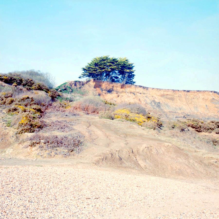

I thought that it might be helpful if I commented briefly on each image submitted. Please take any criticism as subjective and meant completely constructively - and of course if you disagree, I would love to hear your thoughts :)
In comparing the individual corrections to the blended version (see the previous post), I placed each correction above the blended version and compared it using the Normal, Hue, Saturation, Color and Luminosity blend modes (in Photoshop).
Ulf: The luminosity of the correction was too dark (it seems too dark given how sunny the image looks); the saturation is too low; in terms of hue certain features in the image are good, others are not quite right.
Art: The image is too bright overall; Color too green (visually - unfortunately I couldn't use Hue Clocks to confirm this); the saturation of the sky is too low (yet the saturation of the stones in foreground is too high). The saturation of the hill in the foreground is too even (which flattens out the image).
Steve: The luminosity is too harsh/contrasty (though - as I said before - it looks great applied to the blended version at 15%); The Hue is quite good (slightly too magenta); The saturation level is too high...
Greg M: The luminosity of the image is too flat; The color balance is too blue (again I didn't use hue clocks, but visually it looks that way); Hue (certain features are very good, others are way off [see the attached image, which is this version in Hue mode above the blended version]); the saturation is quite uneven (the yellow flowers and some of the greenery are very good - other areas are undersaturated).
Greg G: Again, given how sunny it looks, the luminosity of the image seems too full; the color of the sky and tree are very good; saturation of cliff is too even (this flattens out the image - see the attached butterfly split - but I appreciate that this may have been to mimic Portra); the hue is good apart from the yellow flowers. I decided that I found the hue to be slightly too red, but obviously this was done to make the image look like Portra. I will ask my student which version she likes better...
Again, I am extremely grateful to all of you for posting your corrections - they have all been very helpful! I hope that my comments above are helpful to you all. I'd love to hear your opinions about each version too; I think that hearing each other's opinions is a great way to develop, as we all tend to focus on different aspects of any image that we work on...
