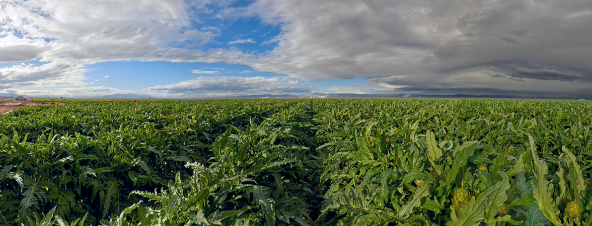

Ok - here's my version. It would be good to know how close the color is to your field Steve...
The image as downloaded was untagged (i.e., hadn't been saved with a color profile); I knew that it probably should be set to sRGB, but Apple RGB opened the image up more, so I chose that (I converted back into sRGB prior to saving the version that I have posted).
The color seemed as though it only needed a slight By-the-Numbers adjustment - and the clouds were bothering me - so I began by working on the tone of the image. CS5's 'HDR Toning' adjustment did a far better job than 'Shadow/Highlights' (I tried both) so I used that (masked for the clouds only using Select > Color Range).

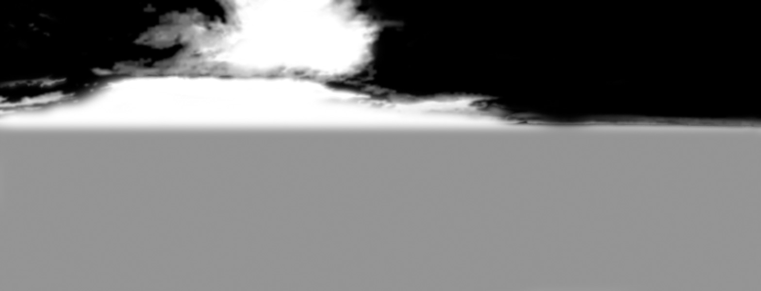

I then applied the image's Red channel (in Luminosity mode, at 50% opacity) to the foreground - as I felt that the field looked unnaturally dark against the sky.
Finally (for tonal adjustments), I went into CurveMeister and applied a Zone 6 pin (from one of Greg's pin libraries) to the sky near the horizon. I didn't like the effect in every area of the image, so I used the mask I have attached to this post to hold the adjustment back in certain areas.
For color, I did a quick BtN adjustment in CurveMeister, and then used some Lab contrast pins to increase hue and saturation variation into the field (I masked the contrast pin adjustments, to protect the sky).
Is this a fair representation of the scene?
Incoming Storm over the Imperial Valley

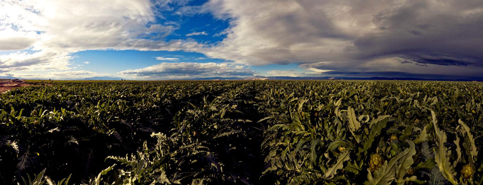

Lack of color profile? My mistake. I did not check the box in save for web and devices. It was sRGB. That adds about 4 k to the file, I think.

At the posted resolution, you cannot see certain problems. I have to start over, now that it is approved. No reason to add fixes on fixes. I did a poor touchup of my shadow in a crucial spot.
Back to the color, the sun was setting, and some of the color were remnants of that.
I will try using the hdr toning adjustment. And later try to reduce the field color.
It is a fair representation of the scene. Since the destination is artichoke people they want bright color correct foliage. The original was dark on the left and yellowish and washed out on the right. I think the greens are good.

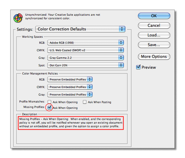

Hi Steve,
Don't be sorry for asking questions! And they're not basic - most people never give them any consideration...
I have attached a few screenshots to show you what to do to have Photoshop alert you to missing profiles. The largest screenshot is Photoshop's Color Settings dialog window (open this by choosing: Edit > Color Settings... - it's near the bottom of the list). If you turn on the checkbox that I've highlighted, you will receive an alert message whenever you open an image saved without an embedded profile.

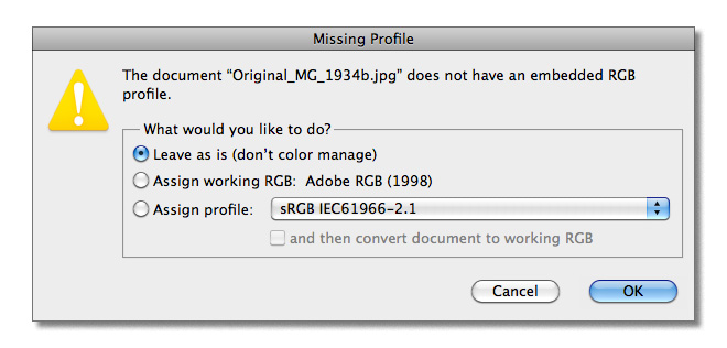

If you've asked Photoshop to alert you whenever you open an untagged image (Photoshop calls images without embedded profiles 'untagged'), you will see the alert message that I've attached.
I don't use this method myself, because the Missing Profile dialog has no Preview functionality, so you cannot choose 'visually' which profile is most appropriate.

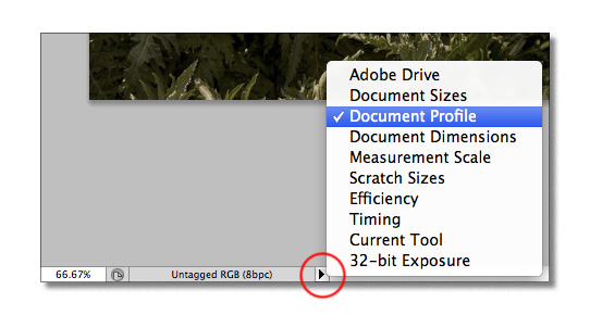

What I do instead is to set the info area at the bottom-left of the image window to display 'Document Profile' (again, please see the screenshot to see how to do this); with this method it's easy to notice when an image is untagged - but it allows me to visually choose an appropriate profile to assign (via Edit > Assign Profile...).

- colorsettings-jpg (109.06 KiB) Viewed 11970 times
- missingprofile-jpg (63.69 KiB) Viewed 11970 times
- documentprofile-jpg (53.77 KiB) Viewed 11970 times

- _mg_1934b-copy-jpg (186.81 KiB) Viewed 11970 times
