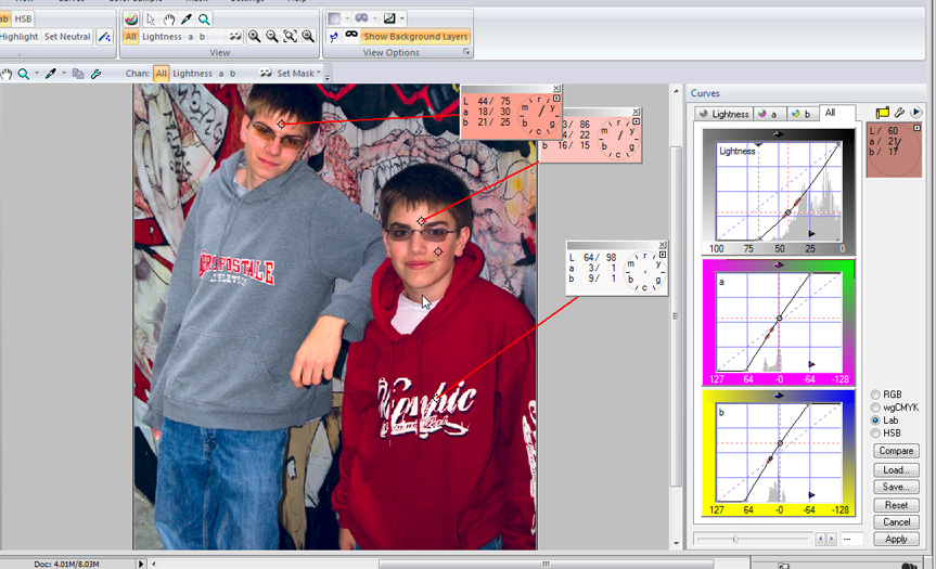

Here is my attempt. I fixed some color and used CM color boost. One problem that bothered me was the exposure. Back boy is darker and bottom right was darker. I did some gradient stuff in LR and PS. The picture is flatter.

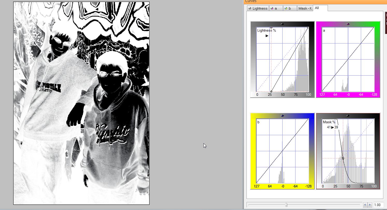

I balanced my version using the L channel in LAB You can create a mask in CM that is based on the K channel or the L channel that is tones rather than harsh black and white...Remember the red tassels exercise in the CM 101 class?? it is in leaving the mask a bit open that you can control the results you are looking for. See shot1
Shot 1 is a K channel mask that limits the adjustment to the darkest areas.
