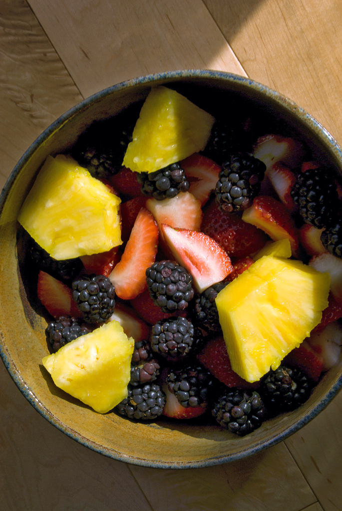

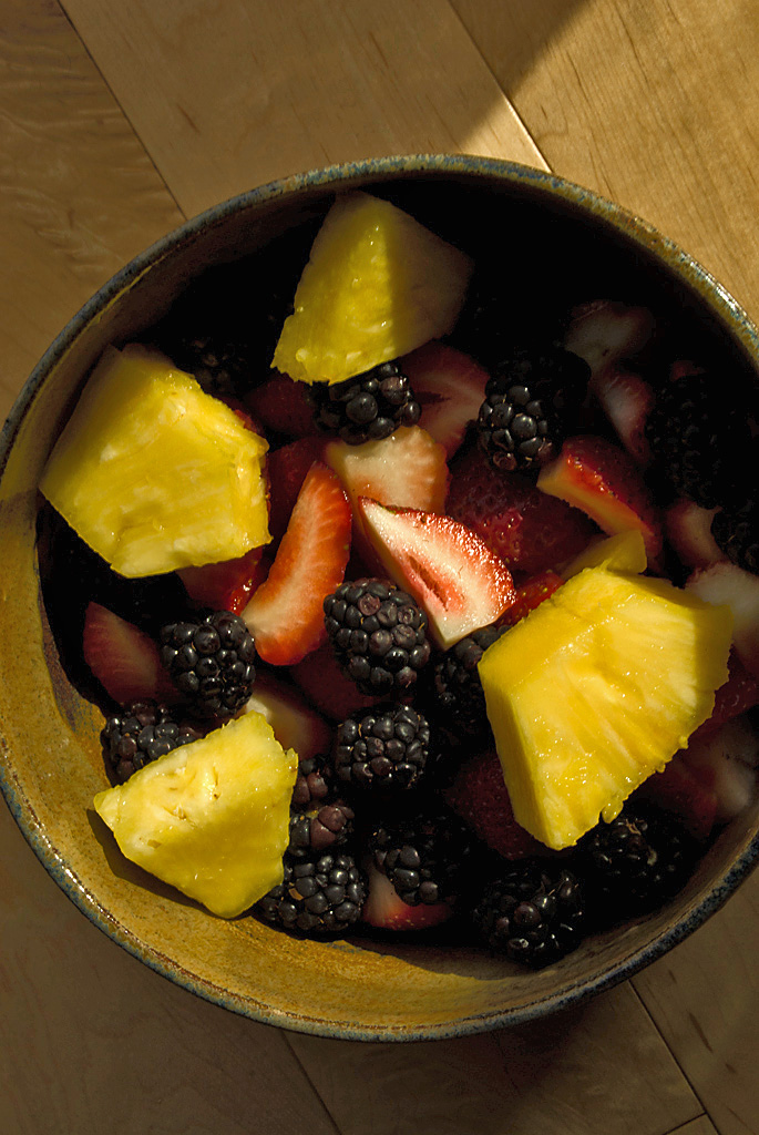

dk,
This is an image that will be giving everyone a tough time because the shadows are really way off.
Another issue is the lack of a solid neutral tone. These combine to make this an interesting challenge but not one we cannot overcome...

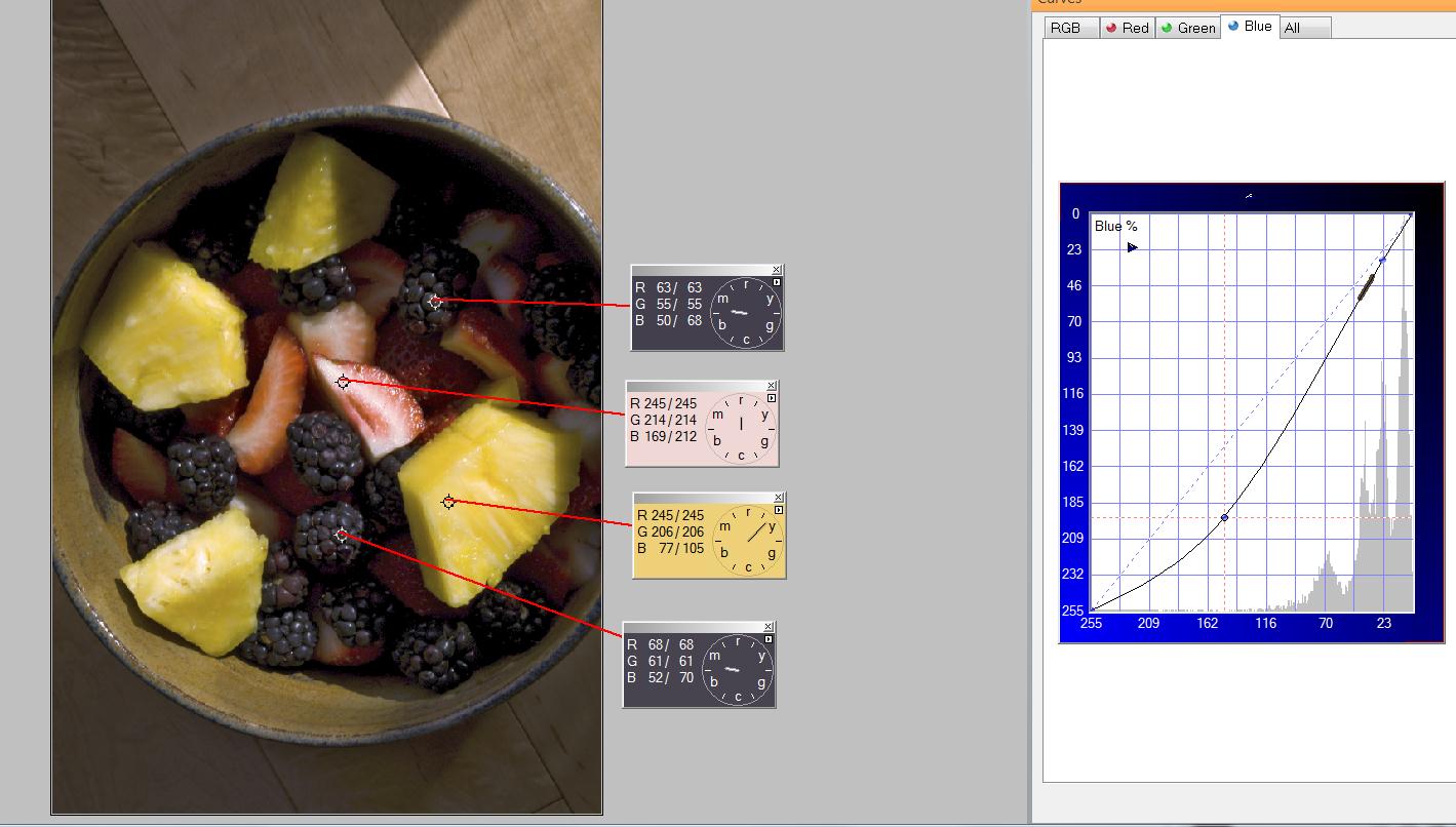

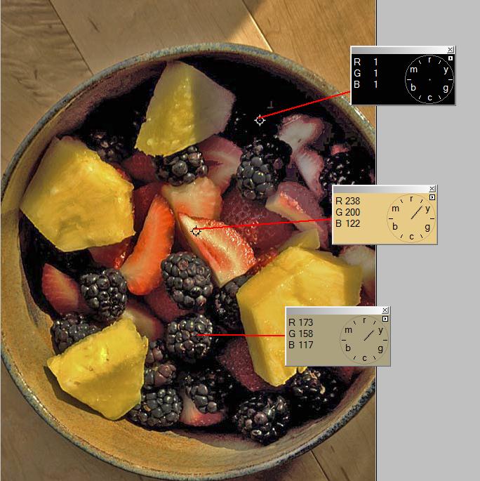

From your posted image I have taken a screen shot. I added some hue clocks to the frame so we can see what is going on.
In the first image you have tackled the majority of the brightness issue but there is more..Looking at the hue clocks the image is too yellow. In RGB you need to adjust the blue channel to fix yellow casts. This is beyond the Color Wizard because there is no neutral to help you get rid of the cast.

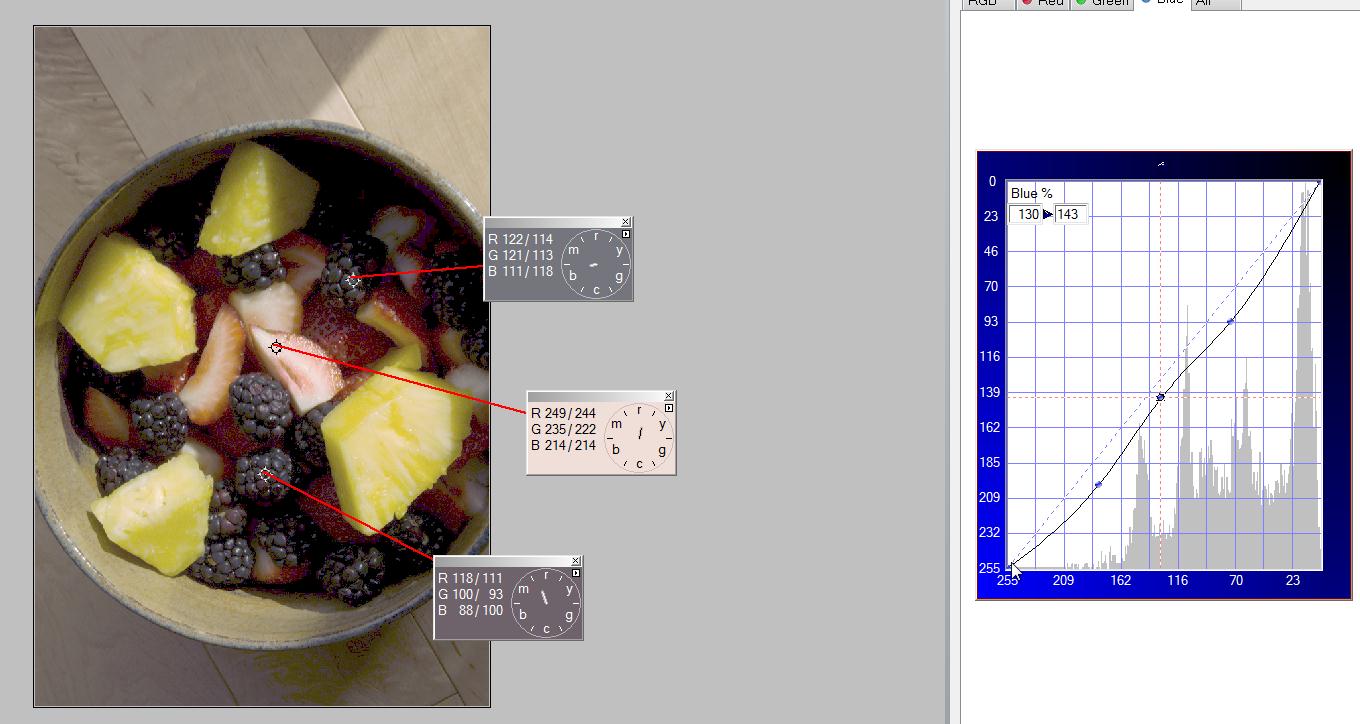

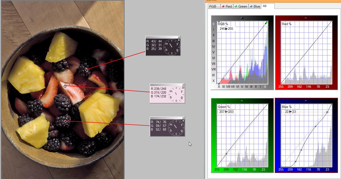

In shot 2 you can see the blue curve I created to reduce the yellow in the berries and in the whitest part of the strawberries.

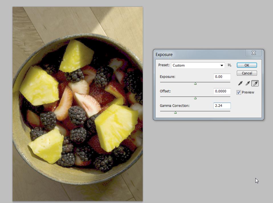

If you want to play a bit with the lighting this image can really benefit from a exposure adjustment in Photoshop.
Open the image before you go to Curvemeister and choose image>adjustment>exposure. Set the Gamma to 2.25 or greater. Then go into CM and see if there is more to work with.
More to Come

Instead of Shadow Highlight try image>adjustments>exposure and set the gamma to be 2.25 or greater...

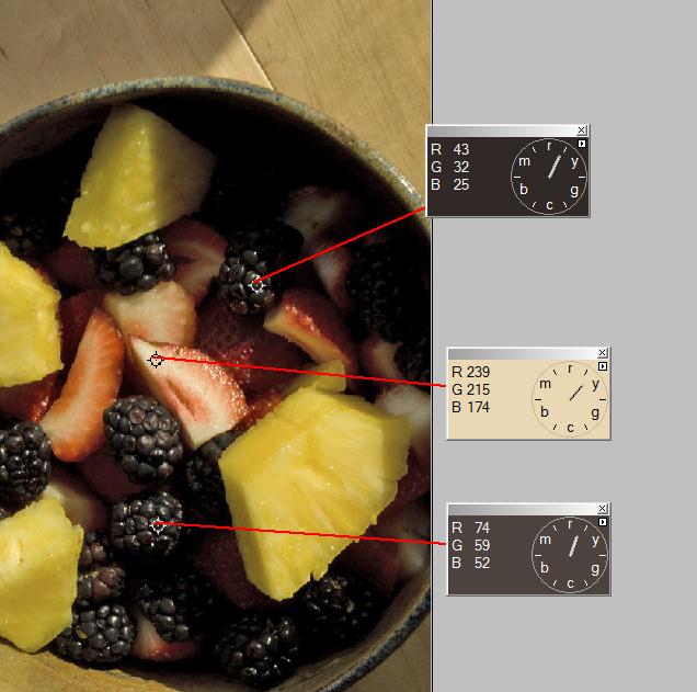

Here is the image with an exposure adjustment....
This is a case where curves alone cannot recover the information in the image.
I used RGB to kill off some of the yellow after I opened the shadows using Gamma.

Why don't we start with easy images! - as (always) this is something that seems simple but is not
I started with lightening the shadows - I use a Dan action as I'm still running PS7 - but I think the S/H filter would achieve the same results.
I then used CM in rgb mode to attempt a colour correction - all at the shadow end
Then another pass of CM in Lab to up the colour a touch
The result did not have enough sparkle in the blackberries, so I applied 25pixels of Local contrast - now I could eat it!

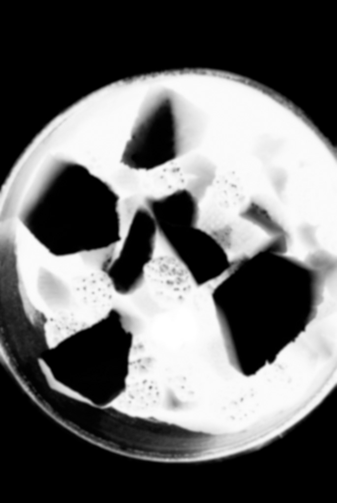

I started off by trying to brighten up the fruit bowl. I opened the image up in CurveMeister and then went hunting for a mask that I could use (to get at the bowl without harming the pineapple); I decided upon a K channel mask, which I copied onto the clipboard (using a technique mentioned later in the course).
I returned to Photoshop, and used CS5's improved 'Refine Mask' function to clean up the mask (which I have attached). To brighten the bowl I did the following (in Photoshop):
Next, I lightened the table using a different mask (attached to this post). To brighten the table I simply did step 1 (above) twice - two Screen mode self-blends.

- bowl_shadows-jpg (61.92 KiB) Viewed 14966 times
- table-jpg (19.11 KiB) Viewed 14966 times
As Zog Pointed out this is a tough image but not impossible...
Things we need to know...
I'll step this out as much as I think I need to but please ask questions
1) Copy background and open Curvemeister.
2) Create a new layer copy and open CM on the Green channel only.
3) Create a new layer copy and open CM in RGB mode.
4) Create another new layer open CM and switch to LAB this time we are going to go after color range and saturation, We have the color corrected so we do not want to mess that up.
5) Create another layer copy and set the mode to overlay. on the overlay layer select Filer>Other>High pass and set it to 3 Pixels.
6) Flatten Image.
Phew...A long ways to go but a short time to create. It took me about 5 minutes to correct the image and about a20 minutes to document the process.

- using CM create a red layer mask and apply it to the background copy. In CM we can open the channels and create masks something we will be learning later in the class.
- Gaussian Blur the mask to 70
- On the image part of the layer choose Image>Adjustments>Exposure; and set the gamma to 2.0 This will open the shadows of the image except where the mask is preventing the adjustment
- Shot 1 is the image before color correction in CM
- Shot 2 is the Blue channel adjustment to the image to get rid of the yellow cast and make the strawberry pink in the center.
- Apply the changes in CM and set the layer mode to color.
- Flatten the image...Again...

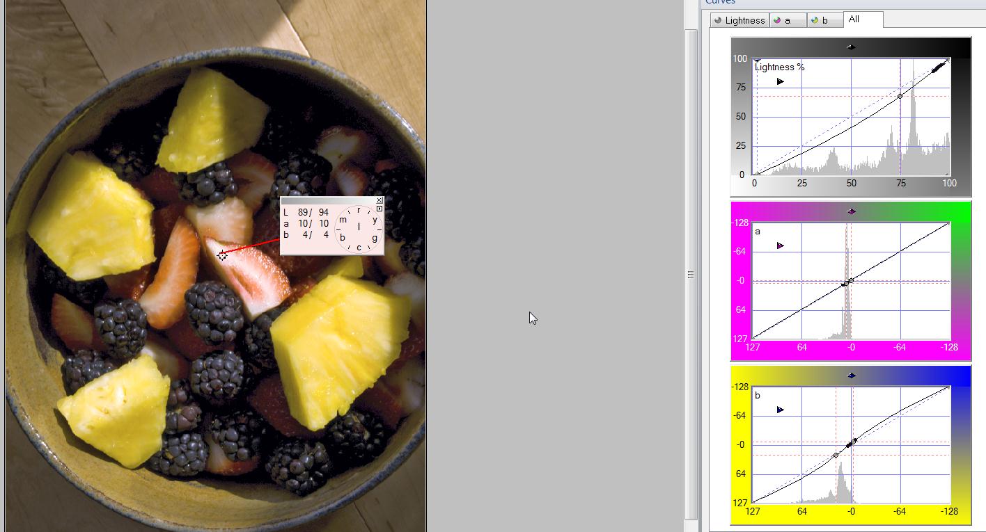

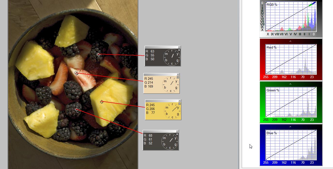

- Set a hue clock on the strawberry as shown in shot 3. This will be your color goal. Your "Home Base" as we adjust the color with LAB we want the A and the B channel values to stay as shown
- Create a contrast Pin on the Blackberry so that you get a decent range in the B channel. We want to add color separation in the berries to give them more shape.
- Adjust the B channel contrast pin so the B channel looks as shown in Shot 3 then move the contrast pins together so tha the B channel value is still 4
- Adjust the A channel slightly to make the reds look better overall and then move the A channel pins together so that the A channel vlaue stays at 10
- Adjust the L channel slightly to open the image to taste and apply the changes

- screenshot003-jpg-12 (124.65 KiB) Viewed 14966 times
