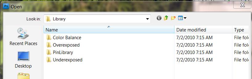

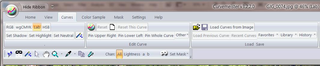

CM provides some curves you can use to fix problems like incandescent to daylight...and vice versa.
In the new interface you could follow the screen shots below.
screenshot001-jpg-63

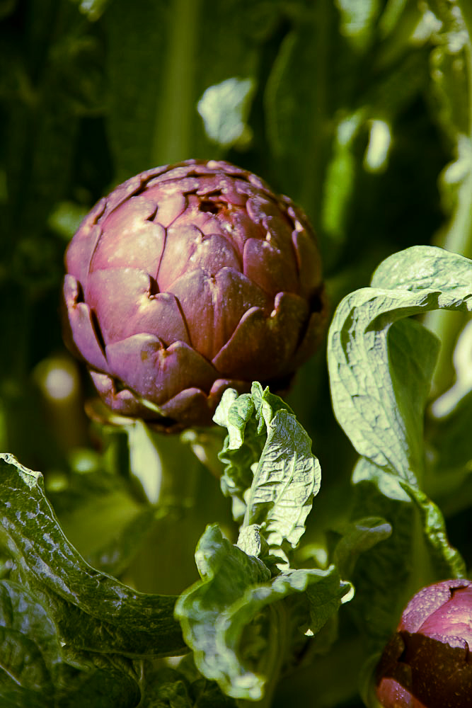

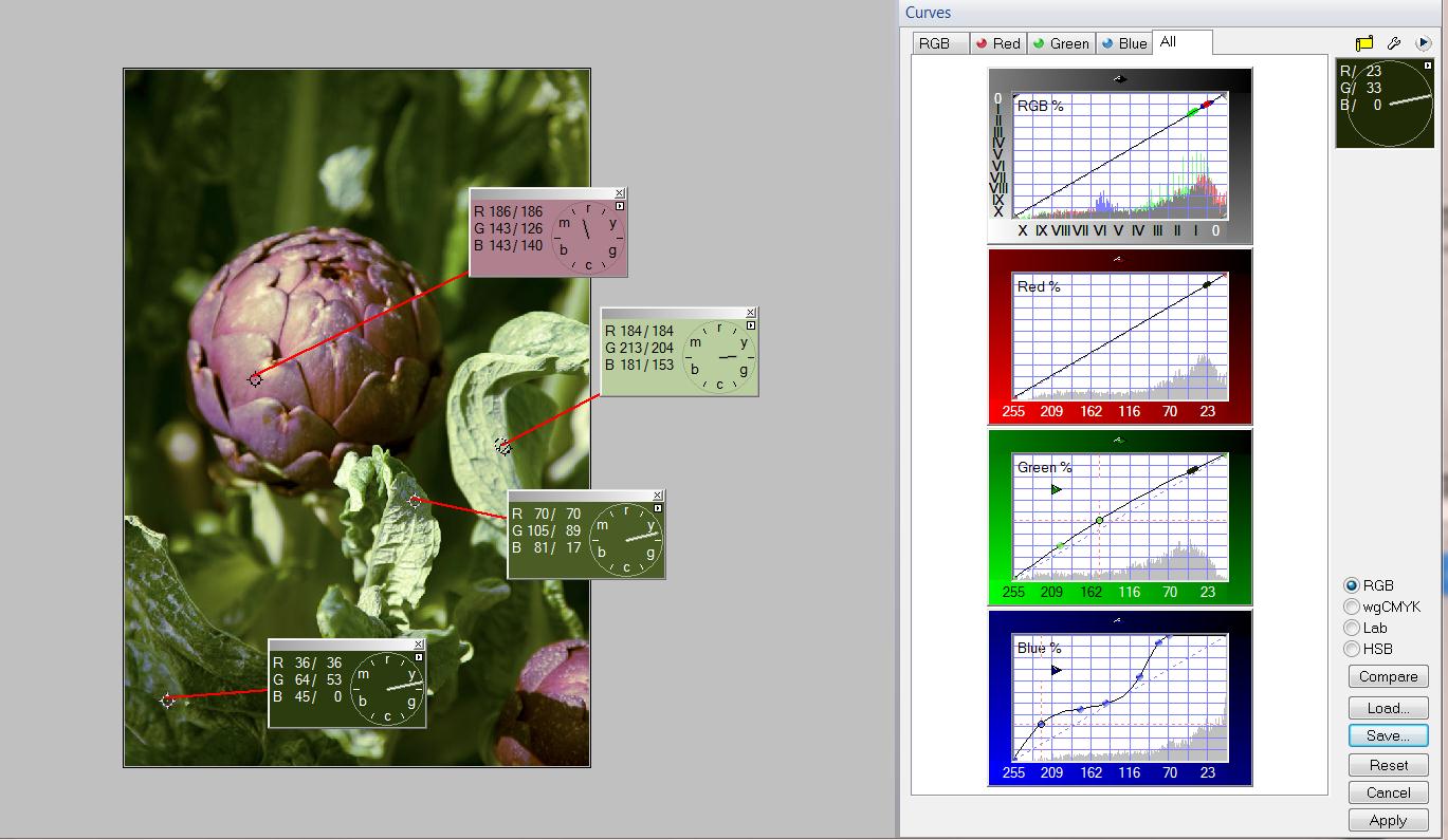

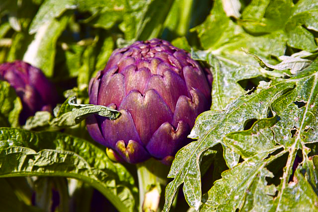

Postby ggroess » Thu Sep 09, 2010 7:18 pm
Thanks.  You may find this hard to believe, I have 5,000 photos of artichokes...  but 43 on my laptop.
Here are two (of 43).
Steve.
In general, when we are dealing with Plant life and greens ..."in general" we want the greens to be more on the yellow side of the green than the blue.  If you look at the screen shot with the hue clocks you can see that I made sure all of the greens I sampled were adjusted so that the hue clock arm was pointed between the yellow and the green.
I also helped the Artichoke itself in the blue channel by making it more magenta than yellow.
Thanks for posting these.  They are great examples where a fast curve can make a large difference in the outcome of the image.

img_0457-gg-jpg (293.53 KiB) Viewed 14450 times
screenshot002-jpg-46
screenshot002-jpg-46 (140.75 KiB) Viewed 14450 times

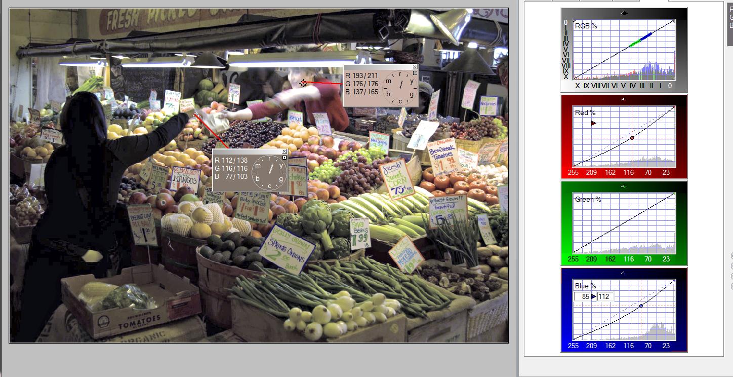

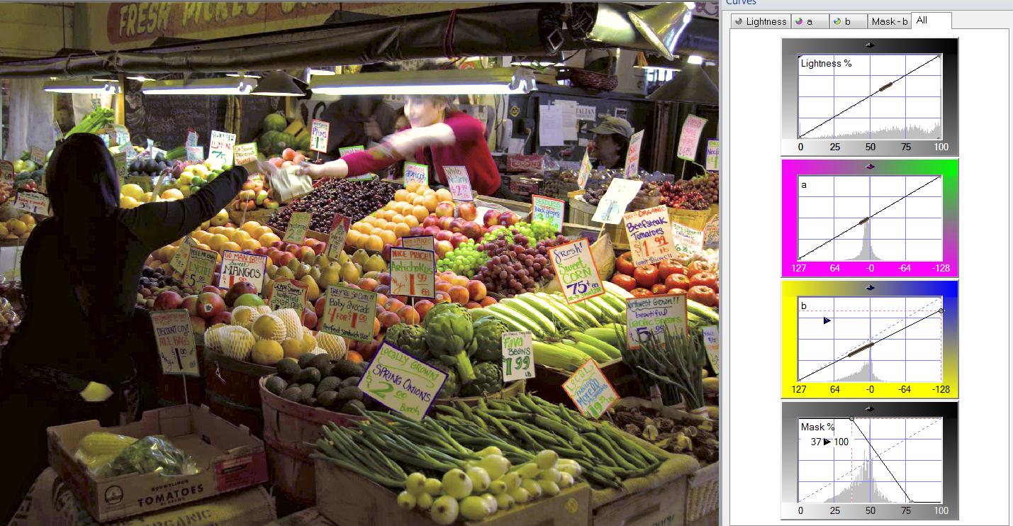

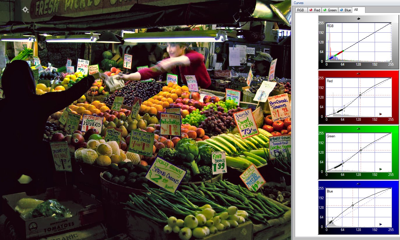

My attempt.  Problem is the mixed lighting.  the background is far too blue.  I used RGB color correction in CM (color blend) followed by lab correction (l channel only).  then I opened the green up in a luminosity blend.  Converted to LAB and boosted the colors (grrr.....  especially the blue).
I used the signs as neutrals.
Steve,
The mixed lighting is truly the biggest problem.
That said we do have some weapons at our disposal now.  In class we are going to cover using CM for masking.  One of the advantages is that you can select a mask based on the color channels and visually adjust it to isolate the offending problem.  I this case the blue fringes from the daylight spilling all over the place.
Here is what I did for this image.
1) I started with the incandescent to daylight curve from the library files...(Thanks Mike)
2) After the color was in a better place, I went after the lighting. I copied the background to a new layer. I opened the channels on that layer; using CM to lighten the Red and Green Channels.  I then replaced the Blue channel with a copy of the red.  It offered me the most bang for the buck as it were.  I then applied the layer in Luminosity Mode. This opened the deep shadows, especially in the black sweatshirt of the customer.
3) I then adjusted the skin tones manually (Shot3) Flatten the layer again...REopened in LAB and Boosted the overall color with the saturation slider.

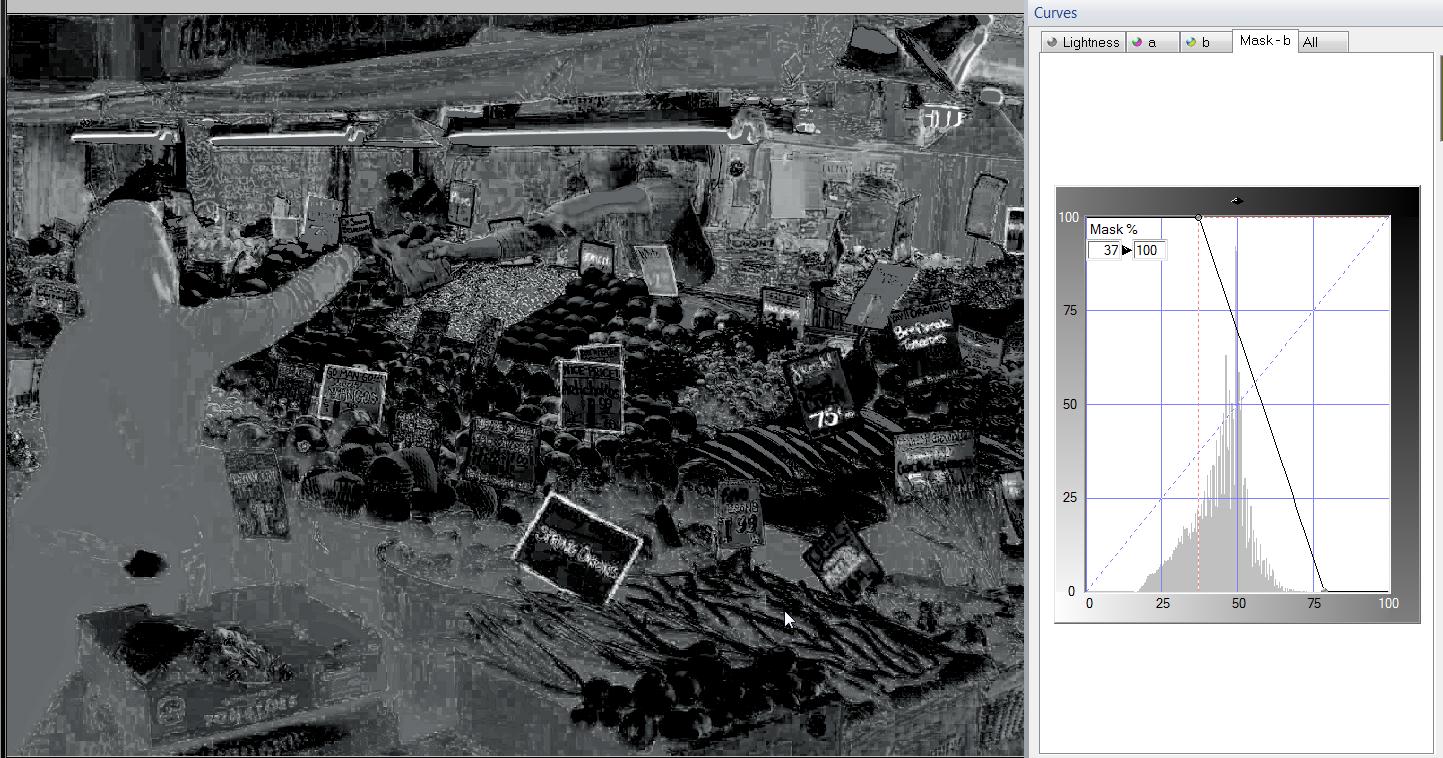

4) Now for the blue fringe...Created a new layer and opened it in CM. Clicked on the mask icon and went hunting for a mask...I tried the red channel and the blue channel but neither would allow me to isolate the daylight fringes.  My final choice was the B channel in LAB since it controls yellow and blue I tried to make it dark enough to remove the color without hurting the rest of the image.  (Shot4)
5) I applied the B curve shown in Shot 5 to remove the blue banding.  The bonus is that it removes it across all areas of the image including the lights and the rolled tarps.  The minus is that it does bleed across the cherries but they should be more red in any case.

screenshot004-jpg-15
screenshot004-jpg-15 (217.63 KiB) Viewed 14450 times
screenshot005-jpg-11
screenshot005-jpg-11 (205.74 KiB) Viewed 14450 times
