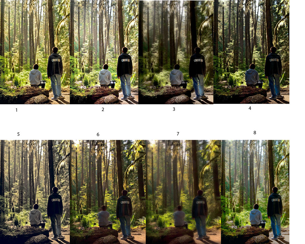

Again to everyone... thanks for trying this out. I can see from the side by side work that there are a few ways to go about correcting this image. I can also see that there is much more to be done besides Color and Contrast to help this image out.
Of the 8 images posted here I would have to say my favorite might be a blend of the #2 and the #8 images. They are not the same size but I might try anyways. I like the lighting of #2 with the colors and sky recovery of #8. #8 also appears to have more directional light which makes this I realize these might be mutually exclusive choices and maybe that is the problem for this image.
Number 1 is pretty straight forward and does a good job of correcting the image problems but the "feel" is not quite right. This is a purely subjective judgment on my part.
I like # 3 for the dreamy quality. Chris are there any adjustments in the process that would allow you to brighten the dark center of the image say by 20% or so? I would be interested in the results of that currently it looks like the center was "Burned" about 20% too much.
For image #4 The darker areas are too blocked up and i lose some of the details that make this image the texture of the tree stump and the details in the darker jacket are important and need to be preserved.
Image #5 has a strong loss of the color green..One of the things we cover in Curvemeister is making the color look good. We are going to have a lot of experience by the end of the class in getting more and more accurate color into the images.
Image #6 to me is a tad dark. It has good color and texture but it feels too dark...I feel that # 7 is similar to #6 in that regard. It looks like the effect was applied to the # 6 image. I do like the ethereal look to the image and may want to incorporate something like that in the final. If I can figure out a way to use it to help make the lighting directional it would be very interesting.

I hear you there...Set up the shot and wait for the light....
But I think the "magic" of this is the conversation associated with it to me and the mental image I have never can quite be contained in the pixels...It could be one of those "never quite right" images that I'll struggle with for a very long time...Sigh...

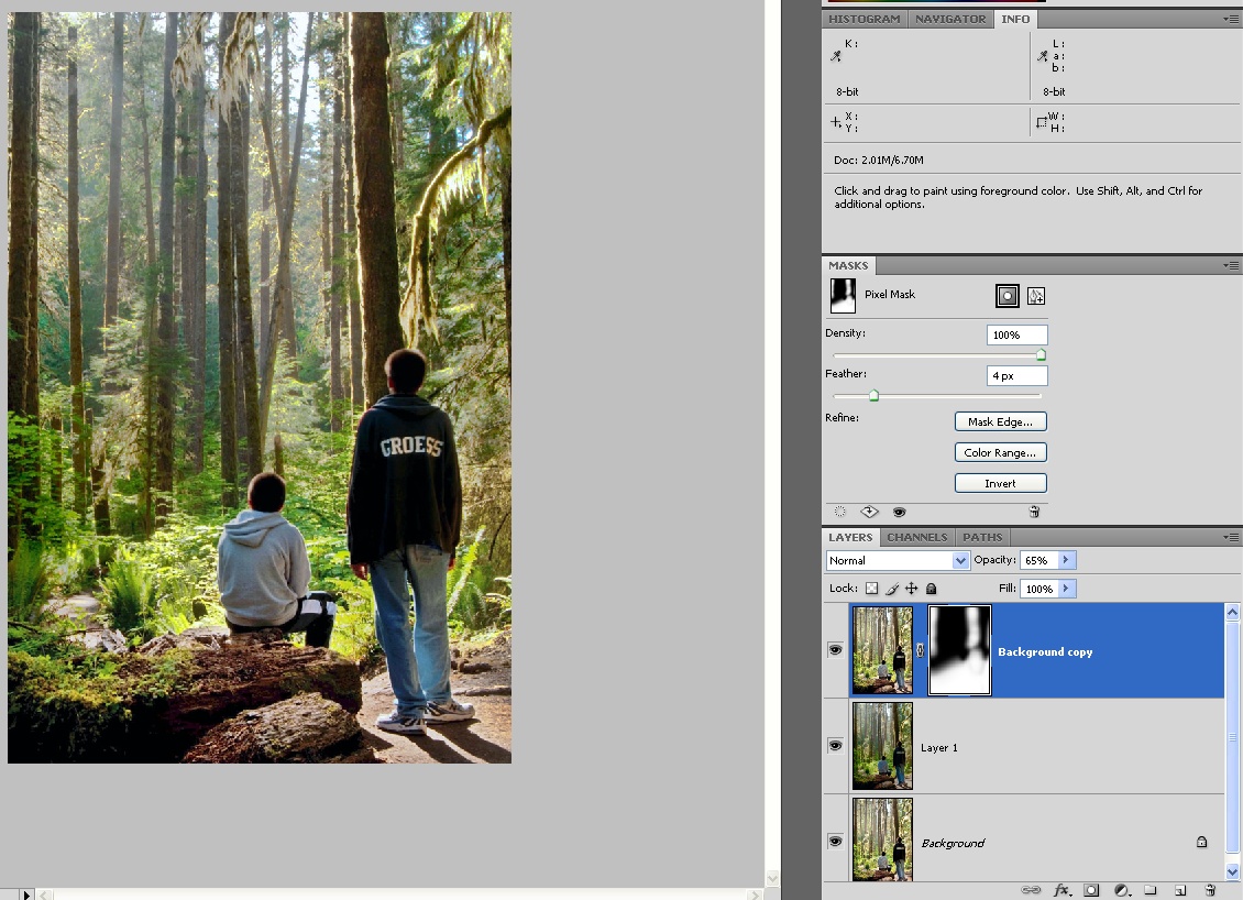

I must say though the blended version is getting closer...I have to get the foreground right so I can work on the trees and the light out in the back third of the image.
