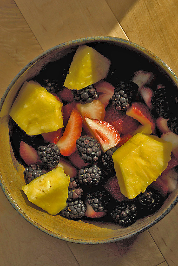

Postby mikemeister_admin » Fri Dec 10, 2010 8:12 pm
Maybe you do not like Q&D but I think one nice thing with CM is that you can get good results for many pictures in a very quick way. Important nowadays when time is a limitation, at least for me :) .
Regards
Thomasd
PS Here is another try with extra lift in shadows with hill in CM and  some extra USM but have to admit blueberries are not blue and have to test Gregs method.  DS
fruit-salad1_td3b_edited-1-jpg
fruit-salad1_td3b_edited-1-jpg (267.51 KiB) Viewed 11186 times

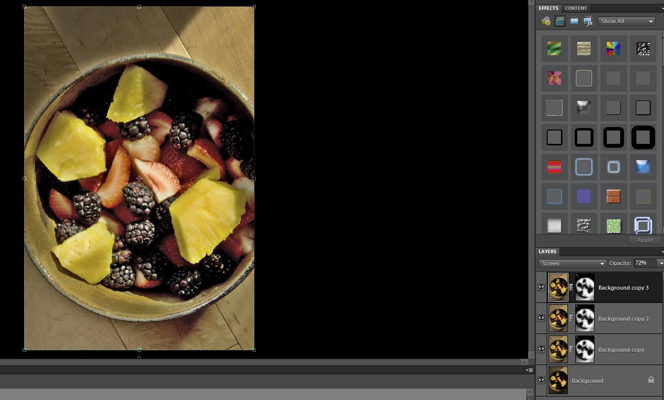

Postby mikemeister_admin » Tue Dec 14, 2010 10:09 pm
Hi Greg
In the workflow I applied the red mask but it didn't seem to have an effect, please can you give more detail of what to do? Also how do you achieve bullet point 3 if you are PSE 7?
Thank you
Andrew
Postby ggroess » Wed Dec 15, 2010 12:56 am
Andrew,
The closest I could get you in PSE would be the "Enhance>Adjust Lighting>Shadows and Highlights"  command.
If that is not allowed in PSE you might try screen as a layer mode times about 6-8 layers to get the desired effect.
Shot1 is 3 screen layers with Blurred Masks
screenshot001-jpg-30
