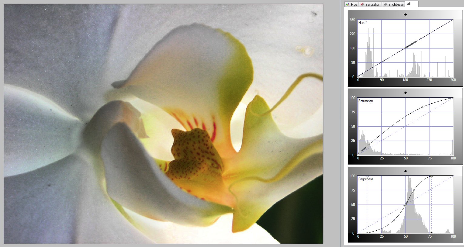

eyecandy-copy-jpg
eyecandy-copy-jpg (243.55 KiB) Viewed 13340 times
eyecandy-darkside-jpg
eyecandy-darkside-jpg (176.31 KiB) Viewed 13340 times
eyecandy-copy-hsb-acv
(70 Bytes) Downloaded 701 times

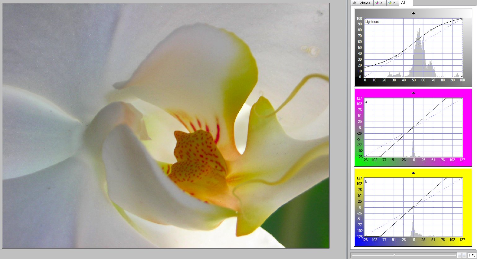

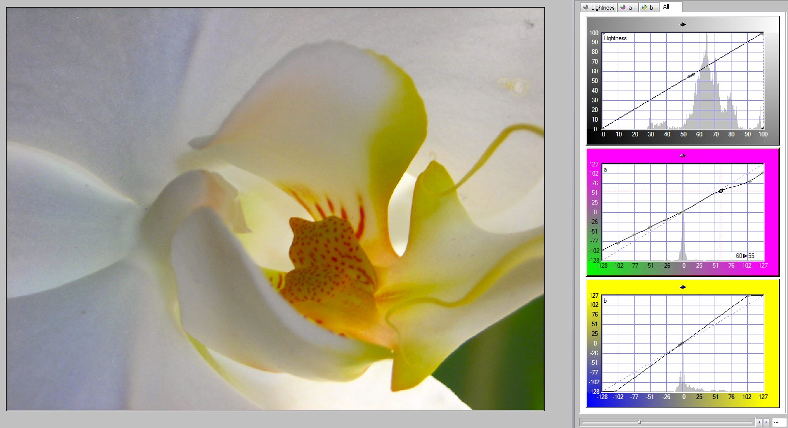

Postby mikemeister_admin » Thu Oct 01, 2009 2:02 pm
A lighter(frontlit) version.GJM. Chris,I like that inner glow you got in that yellow thing in the middle of the flower,it looks like it's ready to eat a human.
snap 1 original version,I lifted the left side of the lightness curve which gave some front light to the petals,then some saturation.
snap 2 after reading Zog's post I thought I could add a bit of yellow to the image.Snap2 is a recreation of the curves.I moved the a channel line  into negative territory,then pushed the b channel for the yellow.Next a bit of touch up in the upper corner  magenta area for the reds.

Postby mikemeister_admin » Thu Oct 01, 2009 2:41 pm
I like that - much more natural than mine (but I like going OTT) and I love the shading on the left petals - a believable image - well curved
Postby mikemeister_admin » Thu Oct 01, 2009 2:53 pm
I was surprised how well lifting the left side of the L channel helped model the petals,also I lifted the idea of more yellow from you.GregM
