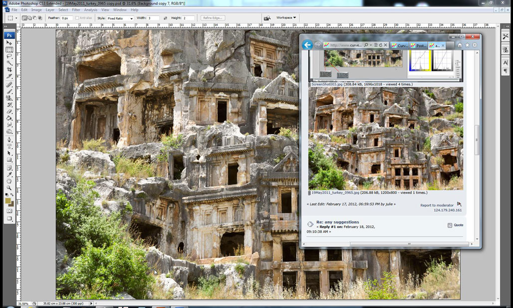

I am a bit concerned that what I see on my screen is so different to what I see through the curvemeister board. It seems to be much pinker/redder on the curvemeister site.
Do I have a problem?

the difference is most likely the browser handling the files differently than you r PC and Photoshop do. When I tried the ACV file the system said it was corrupt so let me try again and see if I can get you to a better place.

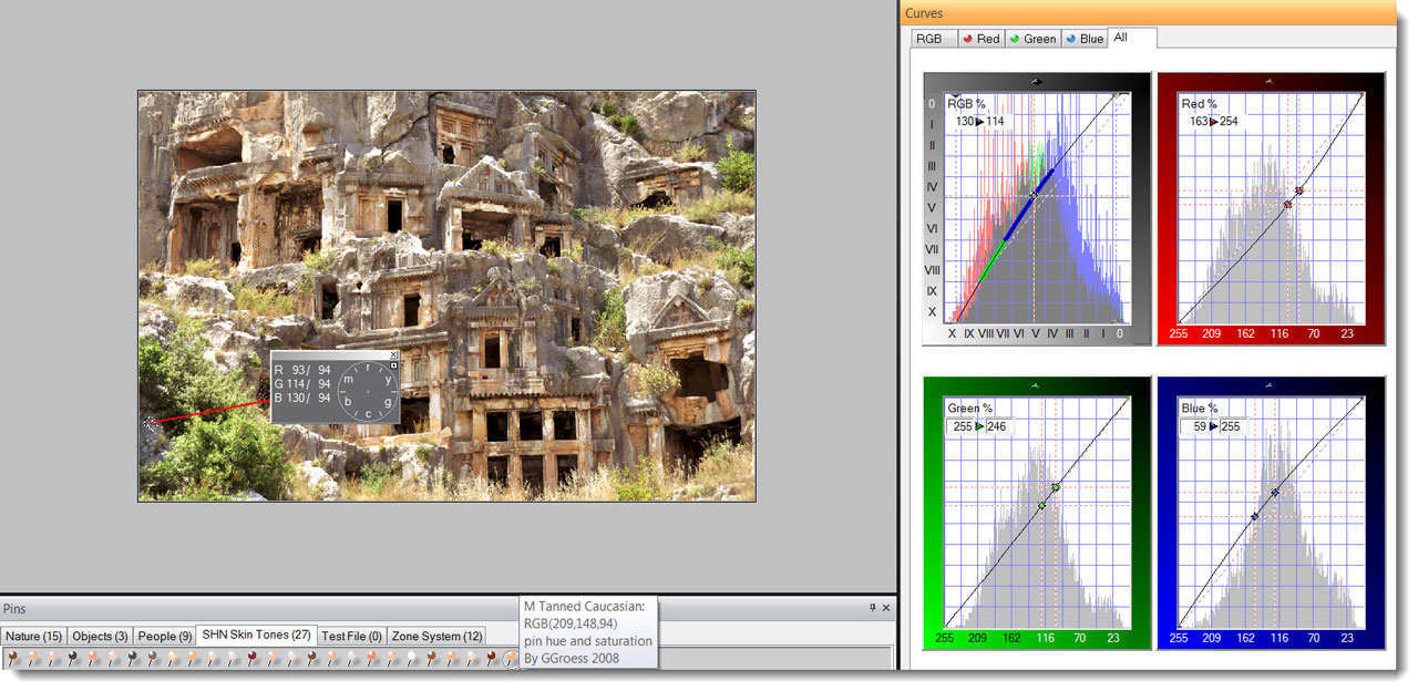

OK Julie...
Try the ACV curves attached in RGB mode. I decided that there were too many "blues" too close together to be able to remove them all in small adjustments. I looked at the "range" of the values that you sampled and settled on trying to get the rocks on the lower left in the bushes to be neutral and about 95 or so in RGB. This seems to kill off most of the Blue cast over the entire image not just the shadows. If the color is just flat wrong I may have been too aggressive.
After I had the color in a better spot I made a layer copy and really smacked it in LAB to get some variation into the yellows and tans. I applied the layer at 56% to keep the Greens in check. Lastly I used a small K channel adjustment to improve the mid tones and give it more contrast.
The attached ACV is the RGB part of the process.
