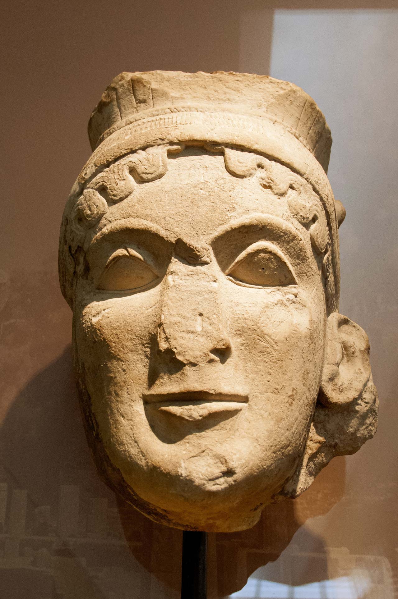

the first image I have decided on 66%
At 100% sharpening it just looks too weird when viewed at 'actual pixels"
Maybe that's ok and I just need to learn how to 'see' a that magnification
I use the slider to adjust the strength on the top layer
I delete the layer that is called 'unsharpened merged'

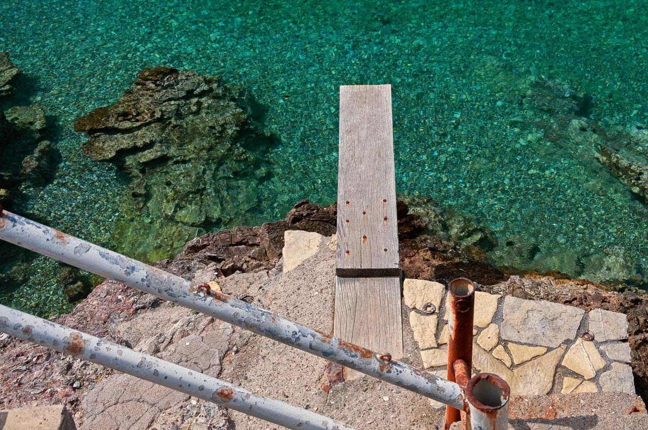

the second one is where it gets harder for me
it was taken in a museum with no flash using iso 2500
So I know I am going to have noise issues
I was juggling the noise and increase in sharpening
One is at the strength I chose the other at 100 %
I would just really appreciate your eye
Both look over sharpened to me at at 100%
But am I under sharpening at the levels I am choosing?
thanks for your time

Here are the other two
I was reluctant to compress too much in case you could not see what I was talking about
The other option is I am looking at the small picture rather than the big one (figuratively not literally). I have a tendency to get bogged in the details and forget the whole.

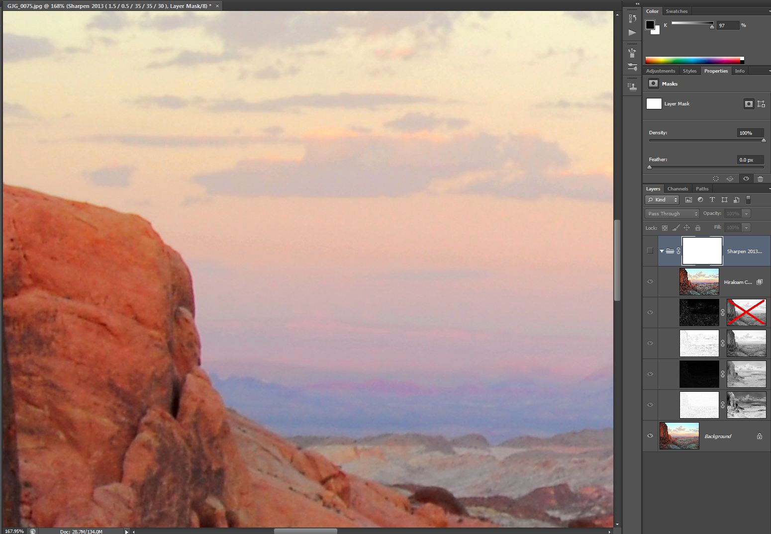

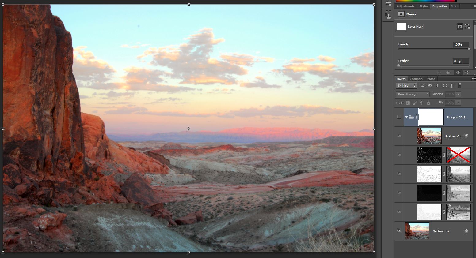

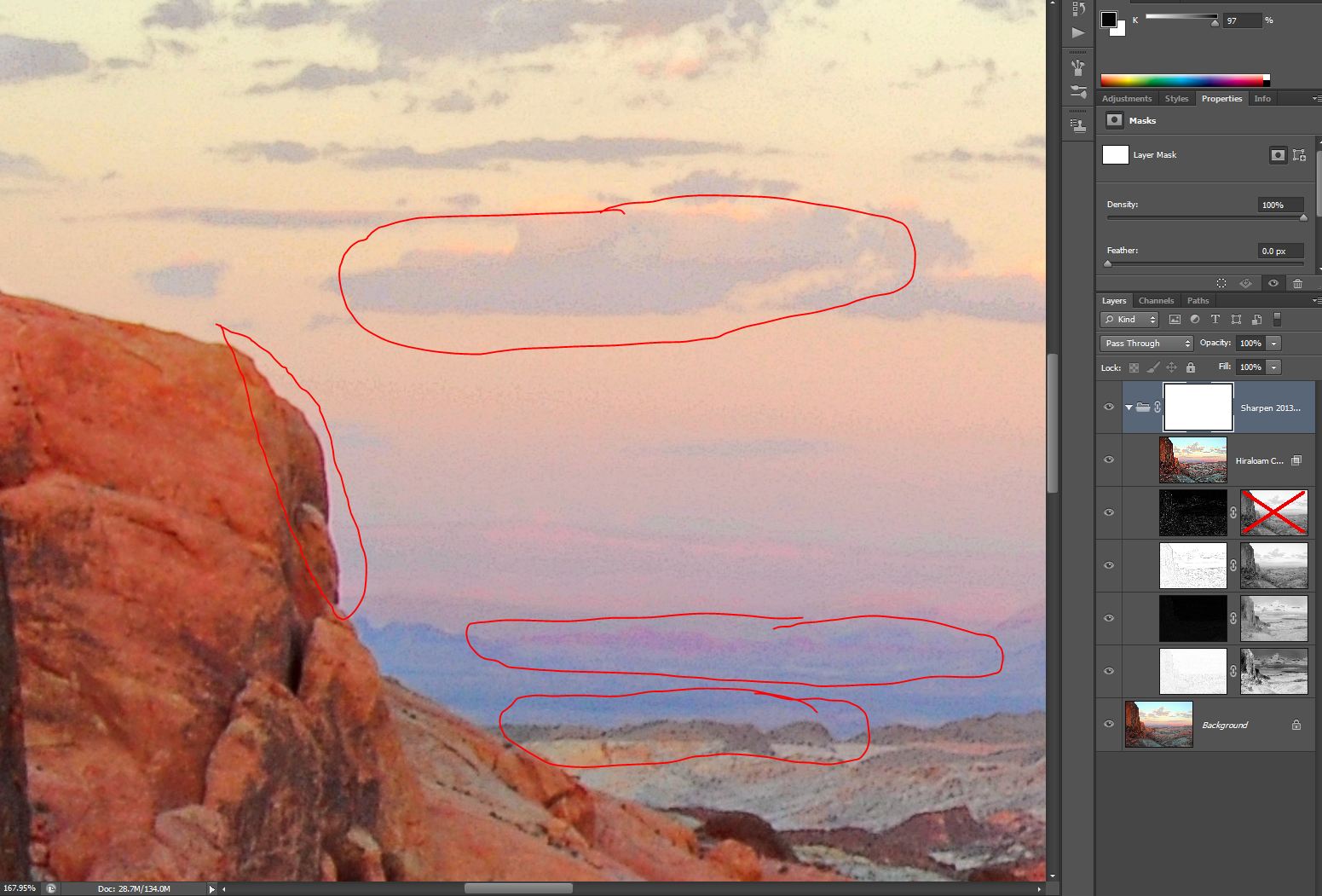

That being said I did not find either of the images to be too badly sharpened at 100% size. While there is noise in the frame most of it on my monitor was due to the JPEG artifact rather than pixel troubles. For me I usually see over sharpening with PPW in the subtle details. See shots 1 and 2 below. Shot 1 is my normal image which has already been sharpened by the PPW sharpening and de-tuned until I was satisfied. Shot 2 is the same image sharpened by PPW and the red circles show the trouble areas.

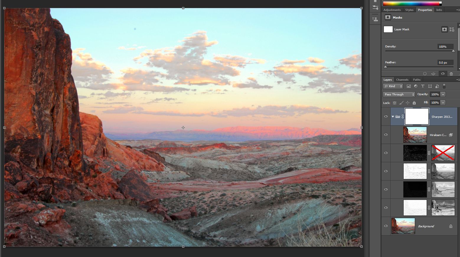

The same image at 30% does not seem to show the same things...Image 3 is the normal image and Image 4 is the PPW sharpened. Image 4 looks great at 30%. But as they used to say in Russia..."Russia is Beautiful country...Just don't look too close." (joking) I hope you see my point.
