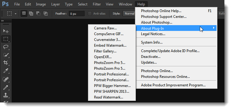

Does it show up on the filters list in Photoshop See shot1 below:
If so you might have to reload your preferences file.

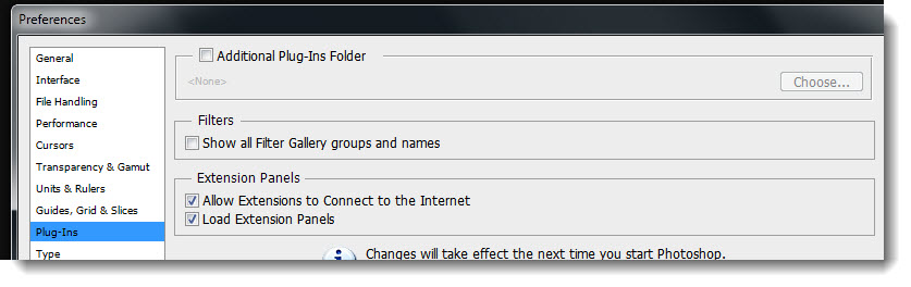

Do you have a secondary Filters folder configured? Photoshop allows you to put plugins into a specific folder: see shot 2 below:
If you have a folder configured put the 8bf file there.

Hi Greg Curvemeister is not listed in the Help menue
Adobe the ability to specify a folder to put you plugins in with PhotoshopCC claims it causes too many problems with users. I found this solution on the Internet that works believe it on not!!
