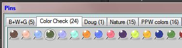

EDIT: also just observed that in pins window, symbols of colored pins are all same except 1 file (color checker), which shows much larger pin heads and show the colors in a larger size which I like. How do I make other folders/.txt files display the larger pin-head?
Mine are all the same size...another question for Mike...

Since I have my pins setup manually so far, and have a process to do so, and don't need many more pins right now, I'll reply to close the loop and one more question on syntax to get large pin icons.

But...would be nice to have a syntax guide for pin files so I am sure I don't have a pin file error and to take advantage of the pin file capabilities....for example how to make a large pin icon in the pins windows; like I see for color checker vs. all other pins....see attached for examples.

- std-pins-size-jpg (17.13 KiB) Viewed 59151 times
- large-pins-jpg (17.83 KiB) Viewed 59151 times
I'd forgotten about the big pins too. I actually like them better because they provide more color information.
They are controlled by an icon name in the pin file.
(there is a single tab between #bitmap and the name)
Here is a list of the pins that you can use:
#bitmap Pin-23x23
#bitmap PIN-25x25
#bitmap PIN-17x17
#bitmap Redpin11x11
I also remember supporting square swatches at some point, which made it possible to display a very nice replica of the Macbeth color checker - not sure if it's still possible to do that or not.
The #bitmap command will take effect for subsequent pins in that pin file. You can add a tab, followed by -bitmap and the bmp name to the end of the line a pin by pin basis, so you can mix and match.
#bitmap Pin-23x23
#bitmap PIN-25x25
#bitmap PIN-17x17
#bitmap Redpin11x11
If you want to support multiple tabs per pin file, use a line like this:
#section
You're correct, Doug, that this should be in the manual. I'll try to remember to do this for the next release.
