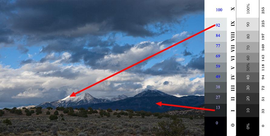

Reading this page, all seems to make sense until he starts correcting an image - it just did not look right to me.
So I copied his example image into Photoshop and then place his Zone image (Greg's 3rd post image) to the right of it to compare the tonal values. This is my first attachment.
I have written L values on his first scale in blue (the right scale is already marked).
You can see that although the IX and I Zone values/percentages roughly agree between the two wedges, they then go quite mad in the middle range, jumping by almost a stop.
Can anybody put me out of my misery and explain why?

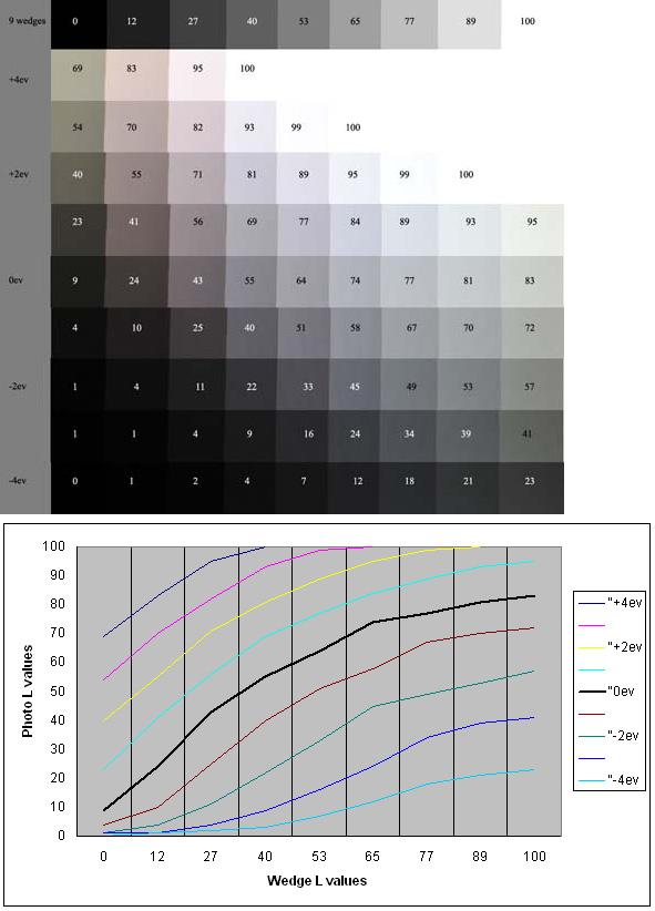

While we are on this subject, if you do as he suggests and take a series of exposures at different EV values of a grey scale - you can then read the L values and see how they change by f/ stops. You will find that today's digital cameras apply a curve to the linear response of the sensor and thus the Exposure Wedge you can construct is not linear.
The second attachment is the result of constructing a 9 step wedge in photoshop, displaying it on the screen and then photographing it through a set of 9 exposures in +/- 4EV steps.
I've stacked them under the actual wedge and then plotted the result.
So my second question is how will this help me determine a Zone value? i.e. Do linear zone wedges show 1 EV differences when displayed/printed, or should one use the ones from the camera curve (which are the photo representations of real life tones and non-linear).
