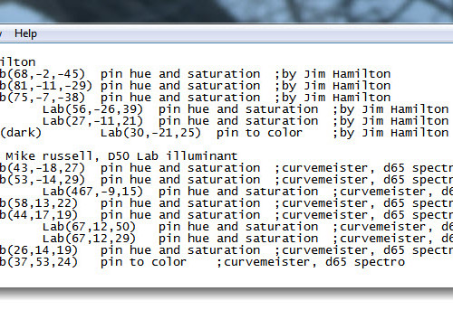

I got to CM from reading Dan Margulis PPW new Color Workflow book and PPW-3 PsCS6x64 panel.
The panel has help docs for color correcting to Lab, including tips for colors.
So I made a pin .txt file for new PPW; attached here for your use
Includes skin, greenery, sky, and soil colors
EDIT:  I made an error in the blue skies and changed the pins to be large....Recommend anyone who downloaded to delete the old file and use this revised/corrected one...sorry 'bout that  (still learn'in)
ppw-colors-txt
(999 Bytes) Downloaded 7 times
Postby ggroess » Mon Jun 17, 2013 12:39 am
Interesting...
You might want to add your name to the end of the string as a comment.
I'll take a look at these.
greg01-jpg
greg01-jpg (122.94 KiB) Viewed 68017 times
