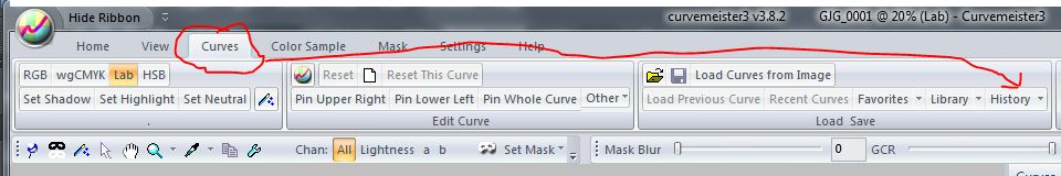

Curvemeister saves Curves as ACV files every time you apply the curve. In the CM interface you can click on the Curves Tab Then go to the right hand side of the interface and select the history drop down and "browse" your history. Every Curve you have applied in CM should be saved there. See screen shot attached:
You can show hue clocks on your image by holding down the Alt key and clicking on the image and that should place a floating hue clock on the image. If you are talking about the main hue clock in the interface screen upper right hand corner you should not be able to make that go away. I would be interested in hearing more about how you made it go away.

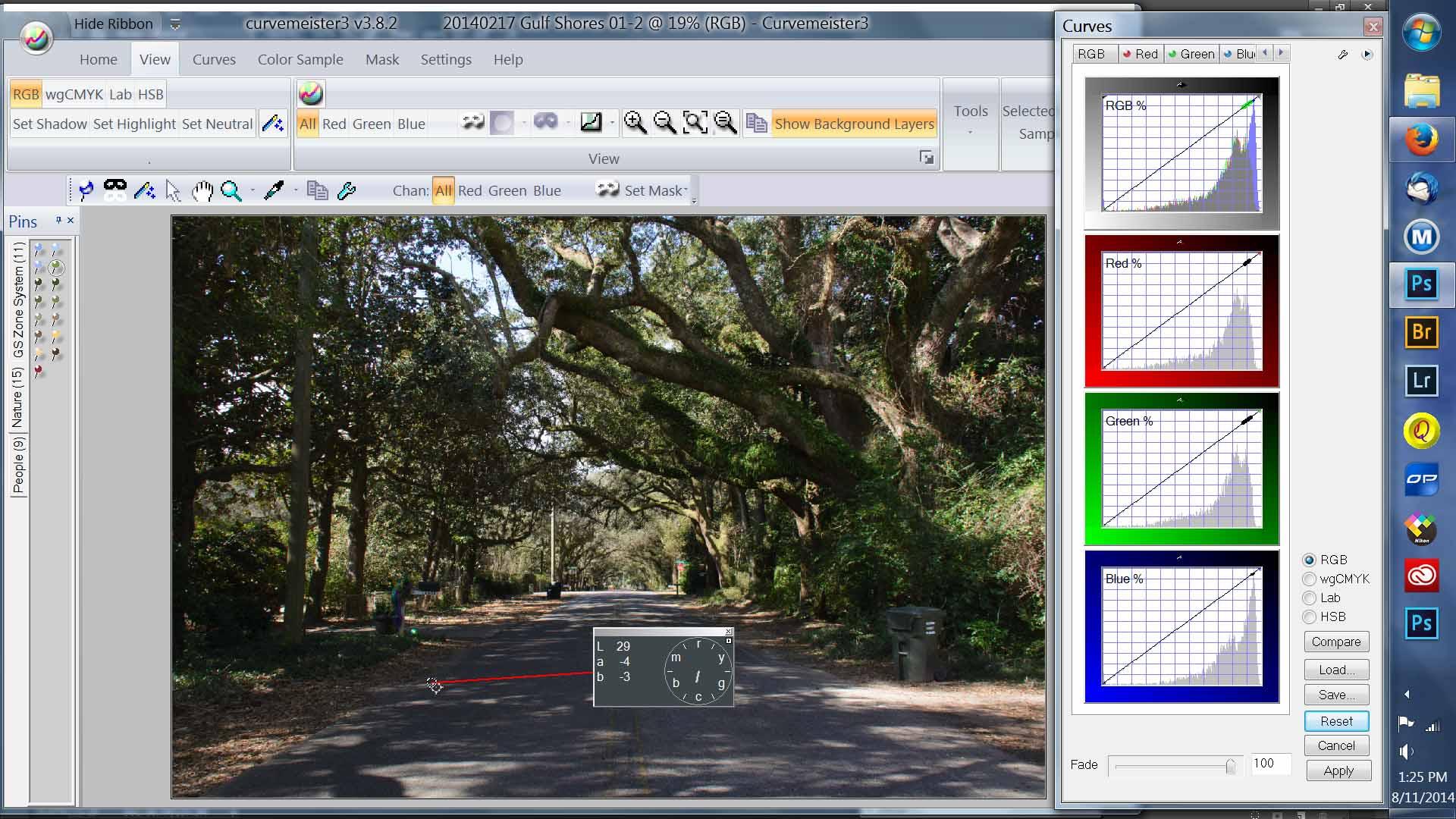

I've attached a screen shot showing the hue clock missing in the upper right corner. It disappeared the first time I opened the program and tried to make the curves side bigger by dragging the edge of the curves box. I uninstalled the program and reinstalled and it came back until I tried to resize.

I cannot make the hue clock disappear like you have...I have un-docked the panel and moved it to all corners of the frame but the hue clock sticks with it. Interesting...
