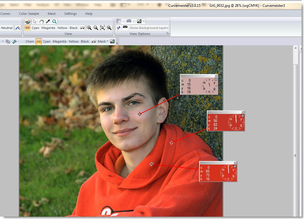

Try closing out of CM and PS and re-opening the programs.  sometimes you might get odd reading out.. you can also try the Beta version on your OS and see if it helps out...
My version 3.015 is a beta but it is very stable so far.  If you want to try it contact me off list and I'll help you get started.
screenshot001-jpg-97
screenshot001-jpg-97 (119.03 KiB) Viewed 13881 times
