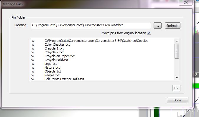

Hi Mike, I have just updated my CM to latest version and thought I'd see if I could save pins - but it didn't work. I can access the 'manage pins' dialogue box but how do I change the location of the pin file? I am, admittedly, a little thick when it comes to computers so I need a little help here. Many thanks and regards, Niels Rasmussen
The latest release of Curvemeister, v3.4.1, the "Manage Pins" command has been expanded to have the ability to change the pin file folder to a different location, moving the pins along with it. There is also additional installer logic to make sure the pin files are writeable after the installation process.
Hi Neils,
The first thing to check is that all the pin file names have "rw" next to them. If they don't that's an important clue to me to know what's happening on your system. Please see the attached image to see how the dialog looks on my system.
Next step is to click on the button marked "...", and then select a folder that you know you can create files in. Curvemeister will move the pins to that folder, and then you should have the ability to save new pins.

- cmmanagepinsscreenshot-jpg (43.47 KiB) Viewed 35710 times
