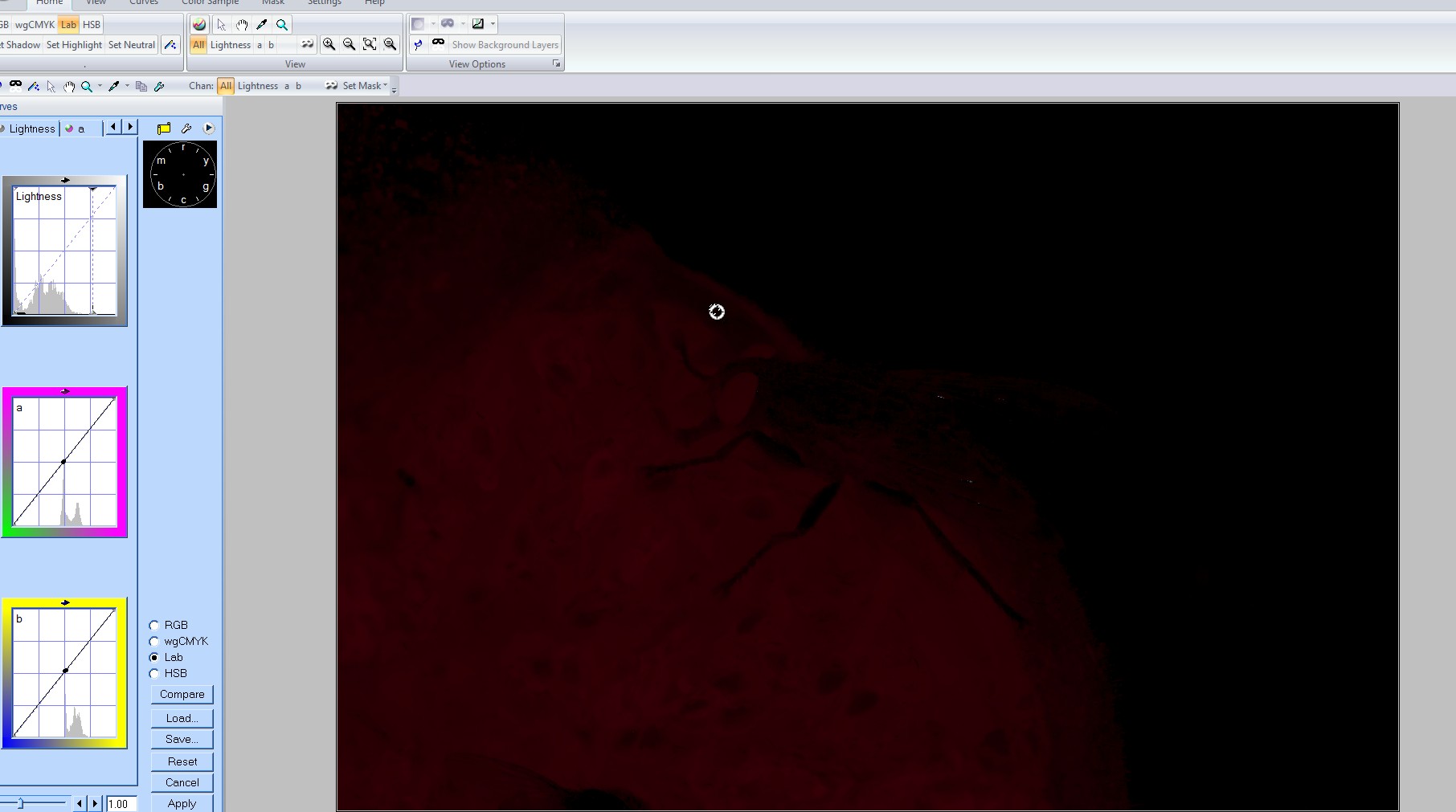

imported_ganna
- Posts: 460
Mike, the problem is only on the Highlight side, both when dragging the curve and when setting highlight point. The screen goes dark, and stay like the screenshot untill the highlight point or marker is removed. Impossible to take a screenshot while I left click on the curve, because it turns to normal when you let go, but highlights (burnouts) doesn't show when I drag the curve. Only happens with the 64 bit version. Hope this helps. Thaks
- 2011-02-04_173324-jpg (152.06 KiB) Viewed 74638 times

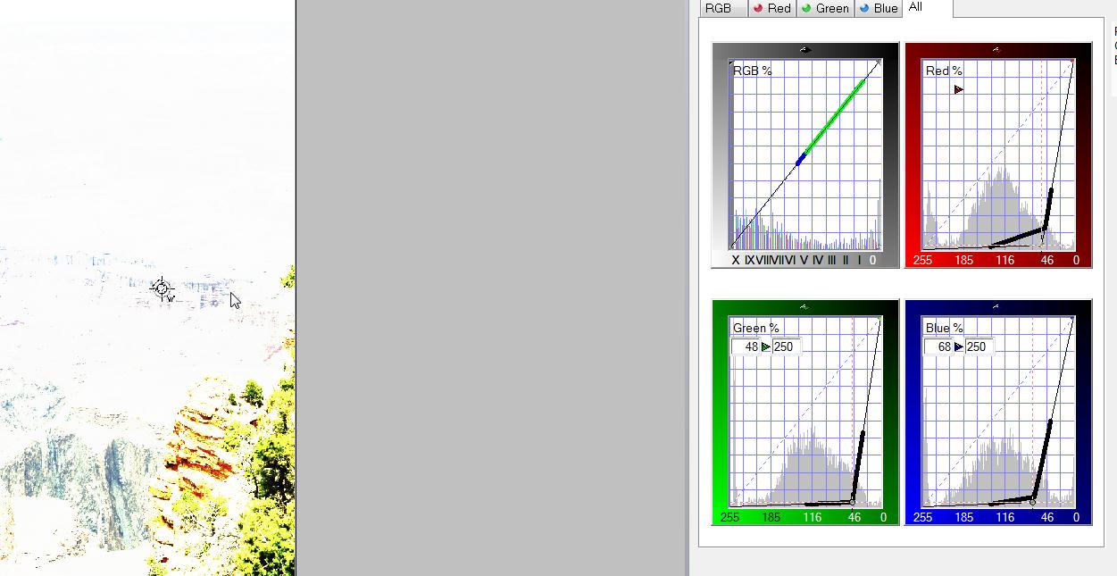

Ganna,
Mine is working normally in LAB on CS5 64 bit. I can set a shadow and Highlight both points and frame edge. Everything seems Ok...BUT....RGB causes the Lock up Ganna is describing...When I go in there and set a highlight the screen stays washed out and changing Modes does not fix it...interestingly enough when you go back into the program after that it works correctly. The Esc key described below also occurs in RGB...
It seems intermittent...
I just had it happen in RGB then when I dragged the highlight to a really bright part of the image the effect went away.
During the effect described I took a screen shot of the image and curves...
When I set a shadow or highlight and then hit the Esc. key it closes CM... BAM! gone....All settings lost. BTW It was a total accident that I found this one...I'm going into RGB now to see if I can find anything else...
So far mostly stable...
