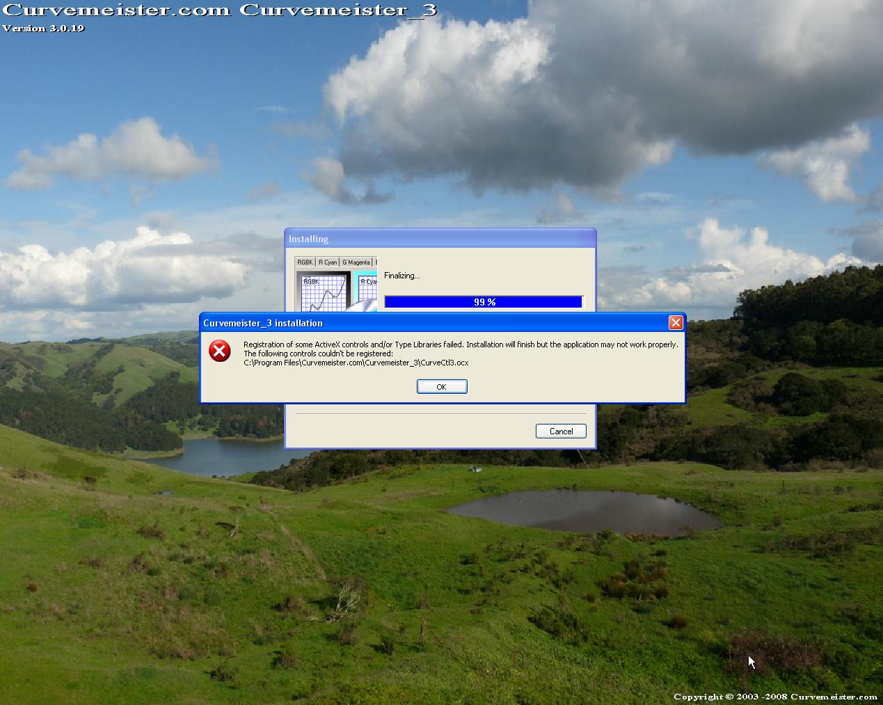

Mike, I get the same result with installing version ..19 as with ..18 and ..15 I reinstalled version ..12 and its running OK. I have XP SP3 with PS CS4. After the attached error code, installation seems to finnish, but  CM is just not visble in CS4. When you look under the Filters menu, CM is not there.

Postby ggroess » Thu Jan 14, 2010 10:06 pm
Ganna,
Is your user account an admin account?  If not you might need to run the install from an Admin account to get the Active X to register.  There is a manual process to get it registered
Make sure you are are an Admin first...My install was flawless but....I am an admin on this PC.
imported_ganna
Posts: 460
Postby imported_ganna » Fri Jan 15, 2010 4:49 am
Greg, thanks for the reply. I am the admin on my PC. I do not know how to run the manual install.
