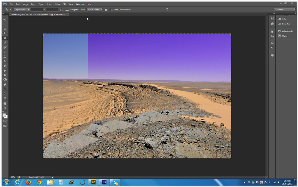

Postby julie » Sun Apr 26, 2015 3:10 am
I'm noticing it again
only seems to occur when using CMYK and a mask
This was a hue mask but as you can see from the above it has happened on another mask
I have included a screen shot showing what happens
The square is always in the same place
screen-shotweb-04-26-15-at-06-03-pm
screen-shotweb-04-26-15-at-06-03-pm (195.13 KiB) Viewed 80254 times
Posts: 1005
Postby julie » Sun Apr 26, 2015 4:20 pm
I just made the sky purple to demonstrate the bug.
It's not what I would have been aiming for
I regularly use CMYK and a mask to remove some cyan from skies
Also it's not visible in CM only when saved to PS
Postby mikemeister_admin » Mon Apr 27, 2015 3:34 am
Hi Julie.
Does this problem happen every time?
Thanks.
Posts: 1005
Postby julie » Mon Apr 27, 2015 4:31 am
Yes but not with every mask. I was able to go back into cm and repeat this to send to you. The original correction was a much more subtle blue
