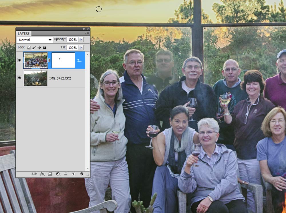

I have not been communicating very well.
Image 1 has the an extra person (third from the left) that I wanted to add to Image 2 (keeper)
3. screenshot 1. shows the keeper (image 2) on top and active with a mask revealing the missing person on the bottom layer

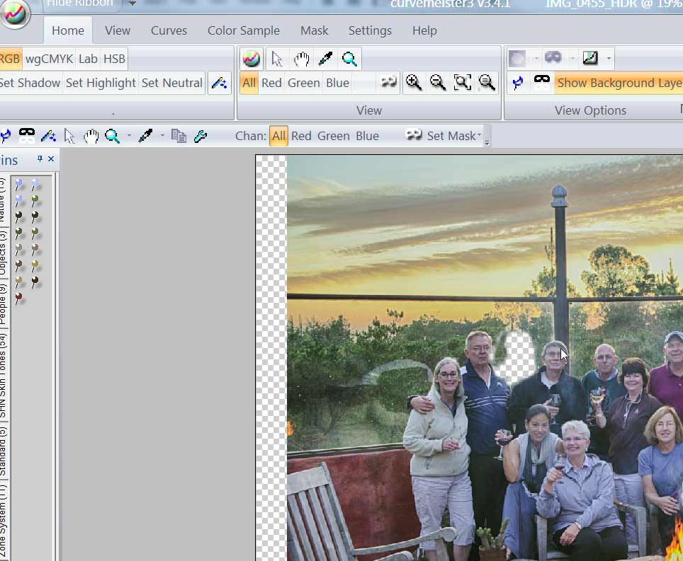

4. Screenshot2 shows CM when the top layer is active. the bottom layer not visible.

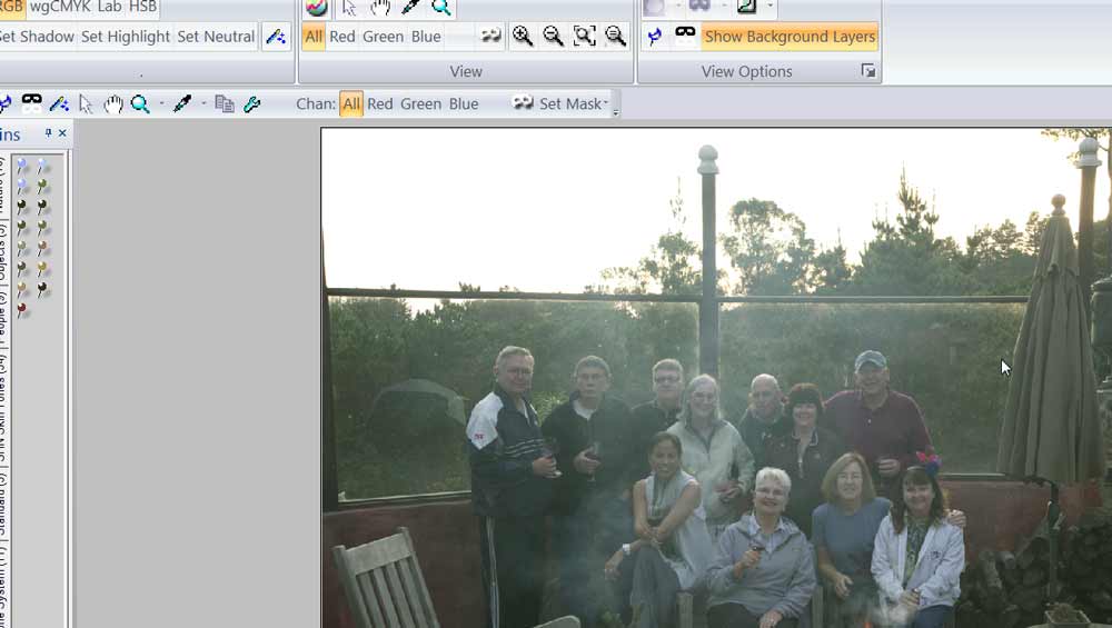

5. Screenshot3 with the same setup as above but the bottom layer is active. I run CM-not much help
I then reversed the order of the two layers.

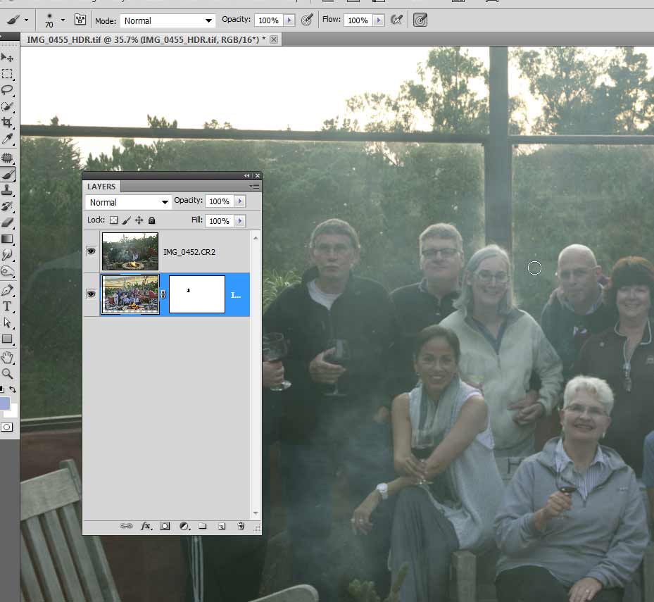

6. screenshot 4. shows the keeper on the bottom layer with a mask.

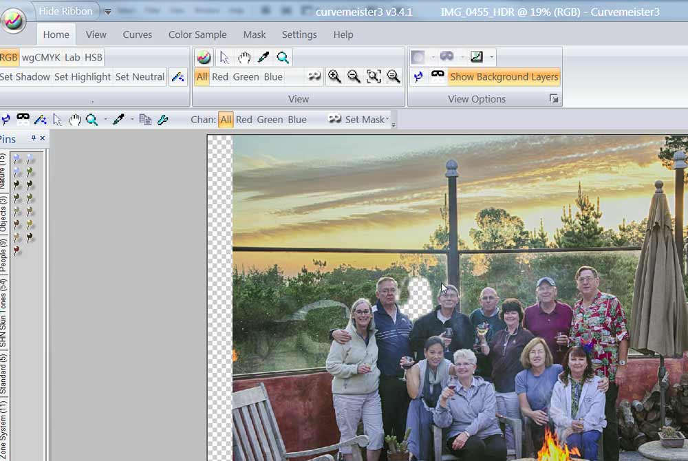

7. screenshot 5 shows CM with the bottom layer active. It only shows the active or bottom layer and nothing from above.
I must be doing something elementary and wrong.

Steve,
It looks like Curvemeister is doing something wrong and not displaying what it should. I have tried with a simple test image with two layers, and Curvemeister always shows the background layer through the upper, active layer. Try toggling the "Show Background Layers" button and see if the lower layers are shown in that case.
When I add people to group photos, I usually put the new person on top of the image, and then use the layer mask for the new image to hide them behind the figures who are already in the image - unlocking the mask from the superimposed image so that I can move the person around. I then use the eraser to get rid of any extra bits around the person I'm adding. For difficult subjects, like wispy hair, I will mask separately, and then paste that on top of the group image.
With the new layer on top, I can use Curvemeister to match the appearance of the new person to the rest of the group, and even use pins from other faces to improve the color temperature. Otherwise I'm flying blind if I can't see the rest of the group.
