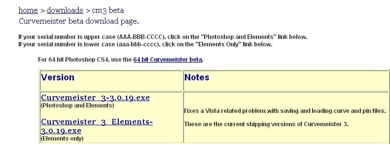

Postby ggroess » Mon Jan 18, 2010 7:36 pm
Brian,
Once you load the VC re-distributable it should be there for you.
Klaus,
If you follow the download link in one of the previous threads you should find the software...let me know if you cannot find it.
shot1-jpg-91
shot1-jpg-91 (68.46 KiB) Viewed 28211 times
Postby mikemeister_admin » Mon Jan 18, 2010 9:05 pm
Please POST the link here. Thanks.
