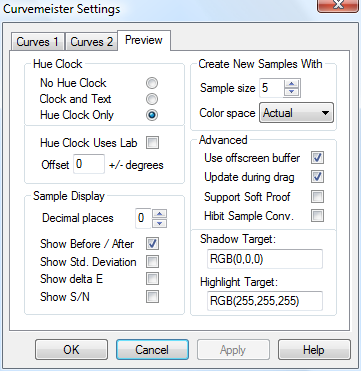

Thanks for the quick reply.Installation went OK except this still happens when I try to set a highlight in RGB.This started several versions back and resists every uninstall,install.The red channel just goes haywire,any ideas?GregM
Wow.  Haven't seen this one before.  My first guess would be that the highlight pin is misconfigured.  Click on the wrench icon to go into settings, then click on the Preview tab, and there will be a value for the highlight, which should be something like RGB(255,255,255).
If that's not it, I'd suggest resetting your prefs using regedit, or we can set up a remote support session where I access your computer.
cmsettings-png
cmsettings-png (33.2 KiB) Viewed 68857 times

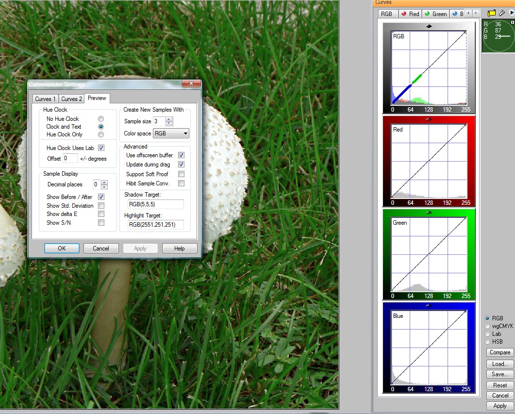

Bit off on that RGB hightlight  target.Thing is that I didn't enter settings for new 3.2 install,they're lurking somewhere in my computer and resisted each uninstall/install cycle for PSE and CS4.Thanks GregM
fungrgb-jpg
fungrgb-jpg (232.58 KiB) Viewed 68857 times
RGB(251,251,251), which it looks like you were intending to use, is probably a better target value, since it will give you a little more headroom in the highlights.
It's obviously easy to make an error here, and hard to get rid of.  I've added this as a bug to the database, and it will be fixed in a future version, and will consider adding another option to reset preferences during installation, which would have also given you a way out of the problems like this one.
