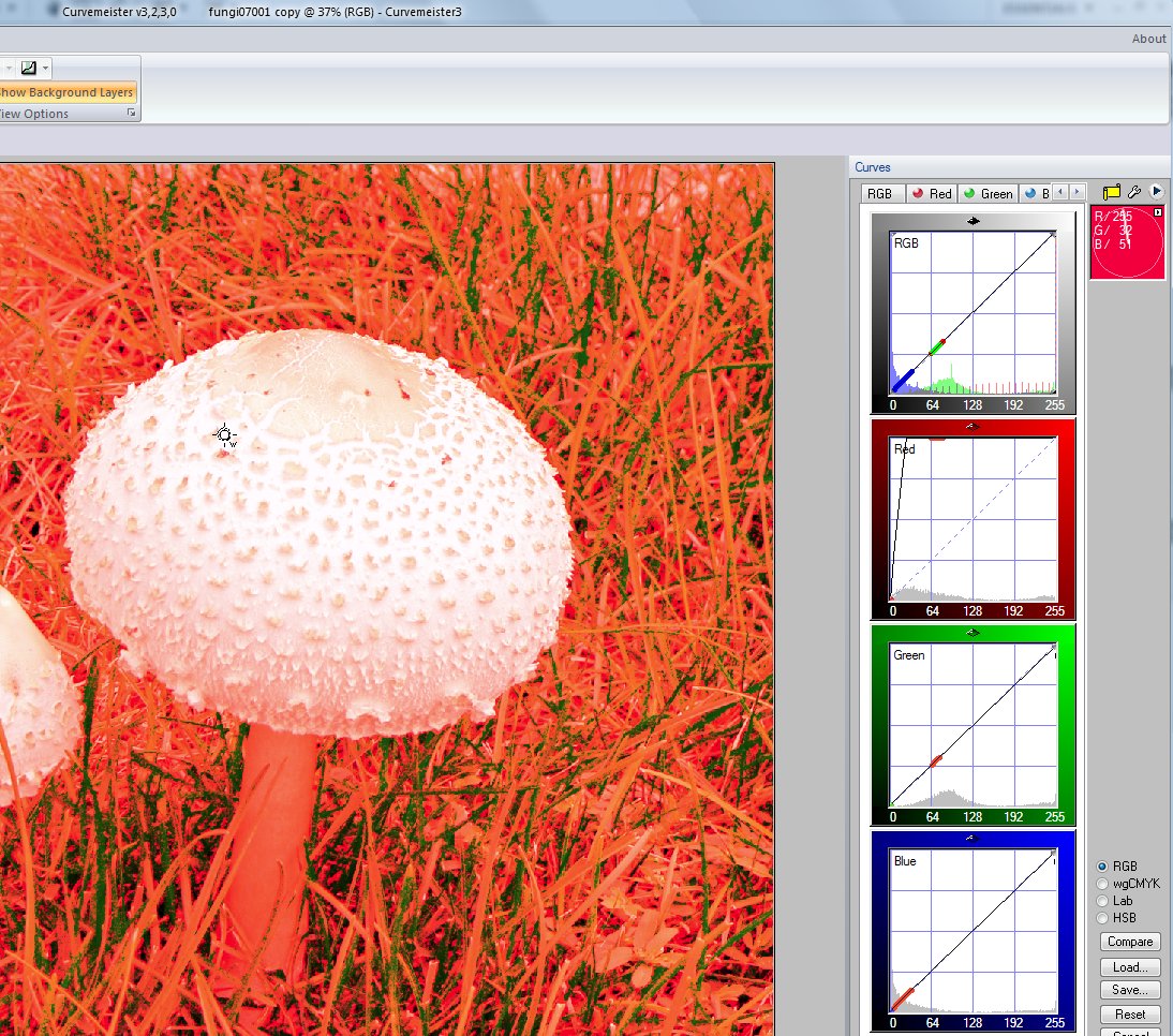

Postby mikemeister_admin » Sat Oct 02, 2010 11:21 pm
Thanks for the quick reply.Installation went OK except this still happens when I try to set a highlight in RGB.This started several versions back and resists every uninstall,install.The red channel just goes haywire,any ideas?GregM

-default
Posts: 1916
Postby -default » Sat Oct 02, 2010 11:26 pm
It doesn't get as far as the serial number window! It happens immediately you run the EXE.
Thanks for the info, Derek.  I'll use a different function to clear the registry.  Hope to have this later today.
BTW - are you using XP or earlier?
