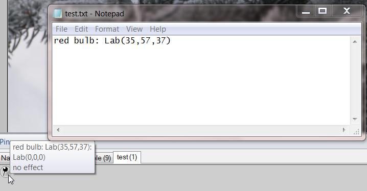

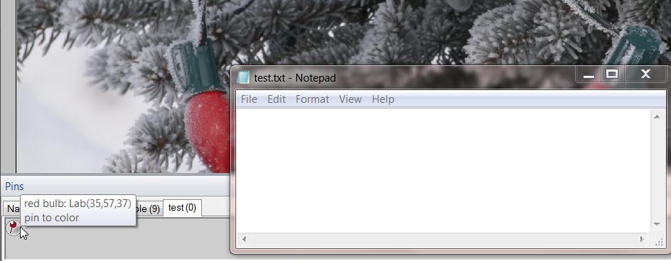

The Pins are better but....See Shot1.
If I create a pin as shown I should see it in the Test.txt file.  If I save the Pin to the File test.txt nothing happens and my Pin is gone when I close CM.

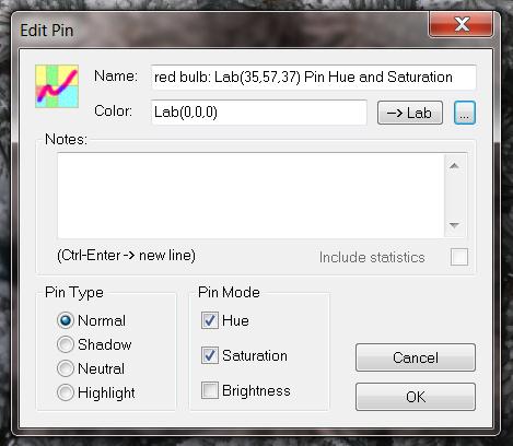

If I copy the pin as text and paste into the file ; the next logical step for me...I check H/S/B in the pin Dialog box and save....Shot 3
Then I copy the pin as text....
I get shot 2.  The pin is there but the data is all wack....When I edit the pin values in the dialog I get the right Pin in the test file.
Seems like If I create and save a pin; it should be a bit more elegant than this...
