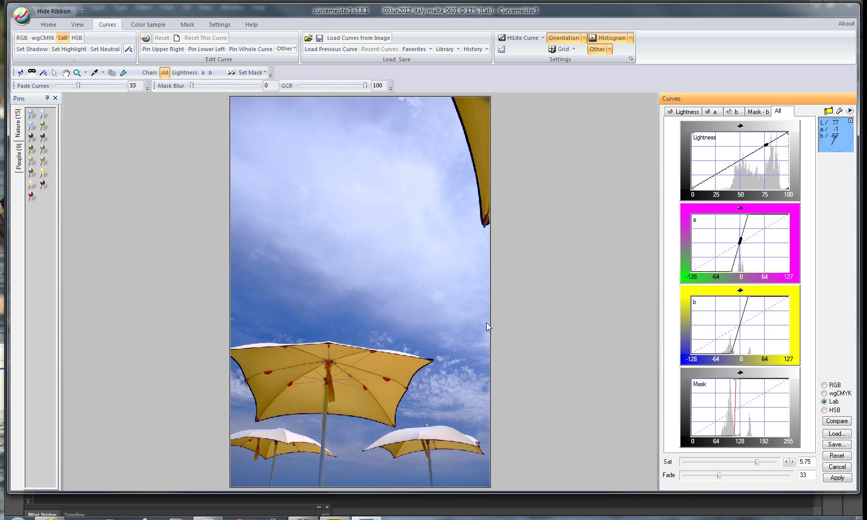

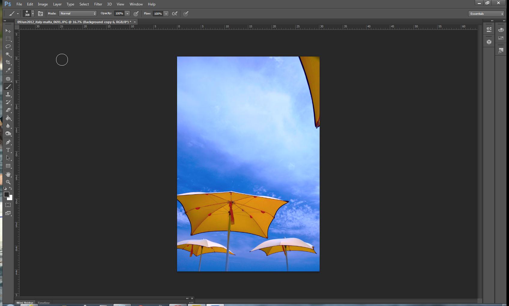

Postby imported_julie » Tue Feb 19, 2013 12:06 pm
happened again tonight
Can you see if I am doing something odd to make this happen from the screen shot?
this does not happpen all the time just sometimes
even when it does happen its not fatal, I just use the opacity in photoshop
any hints

Hmmm - this is definitely an interesting bug.  Is this a 16 bit per channel image, perhaps?
Postby imported_julie » Sun Feb 24, 2013 8:03 am
showing my ignorance, but I dont know.
How can I find out?

Postby imported_julie » Tue Feb 26, 2013 12:26 am
I figured it out
Its an 8 bit image
should it be??

Postby -default » Tue Feb 26, 2013 9:10 am
Julie: I think you have found a bug.  I will try to recreate it.  My guess at this time is that fade does not work for certain color modes.

Postby -default » Wed Feb 27, 2013 12:18 pm
Hi Julie - No need for you to do anything.  It's my job to find out what's causing the problem.
Thank you very much for finding the problem, and describing it so clearly.
