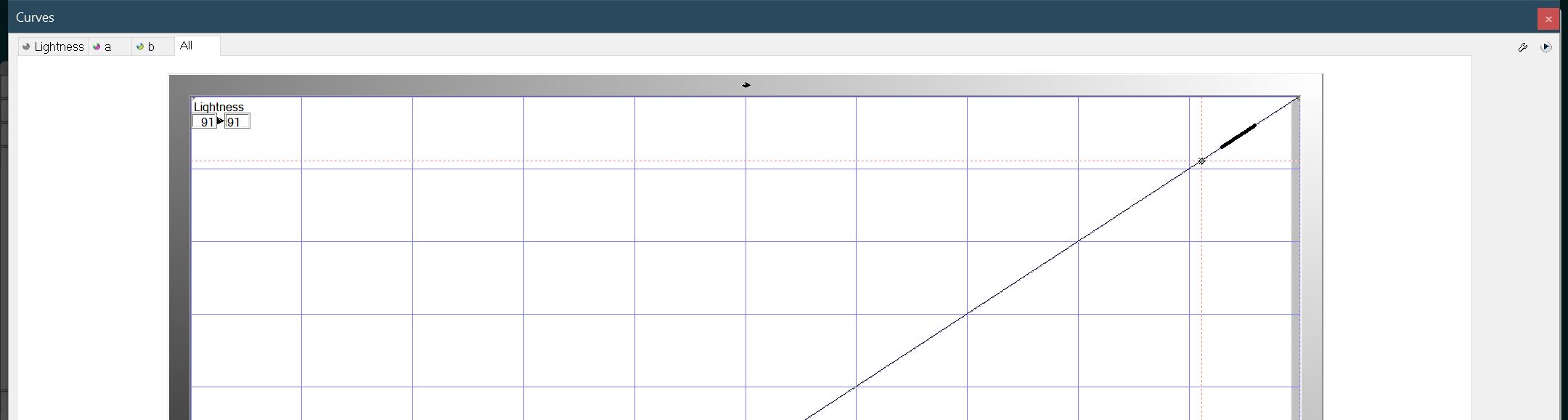

Re: new install won't work - not registered
I think I have tried all the setup and tools, and all looks good....
except I remember on the curves window display I always had a color/hue box that displayed the current selected point on the curve to show me the colors/numbers. It was always on the very top right of the curves window.
But I can't remember or figure out how to make it display there.
Any suggestions as to the setting to check/mark?
Doug
Doug

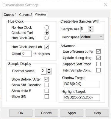

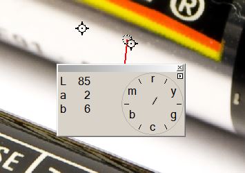

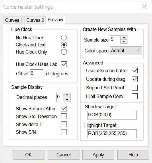

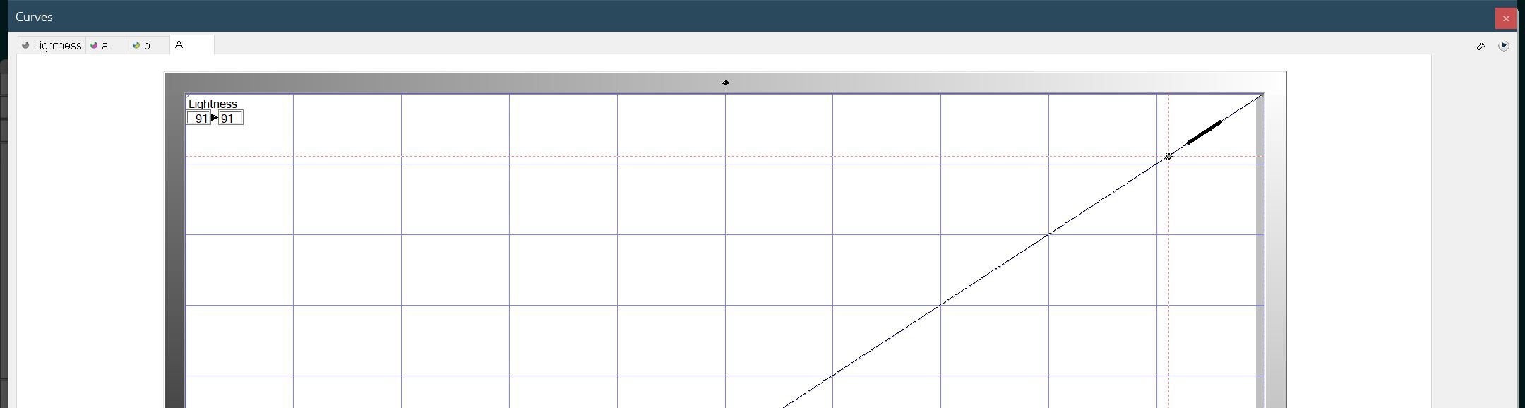

Thanks Greg, but does not seem to work. Have restarted CM and Ps several times. Have tried turning Hue Clock off, w/wo text; no change.
See attached .jpg screenshots.

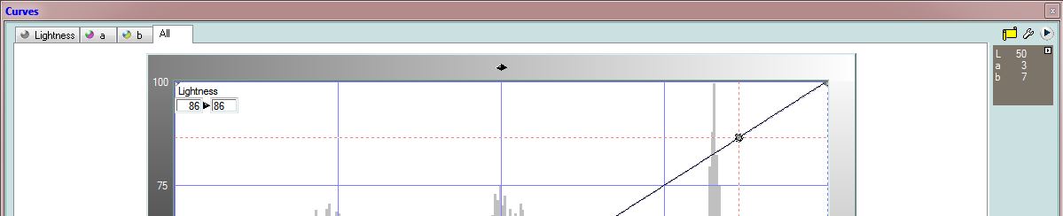

I went back to old win7 PC (same 3.8.2 CM ver.) and sure enough the hue clock is there tracking my mouse pointer position to display hue clock and Lab (set that way) color numbers.
Any ideas? or is this a new bug?
Doug
Doug
- Posts: 683

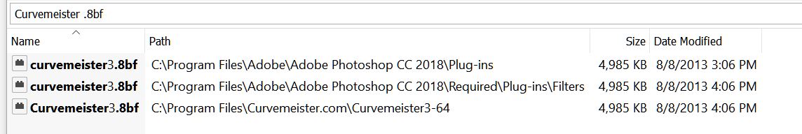

Doug,
Do a search on your C:\ drive for "Curvemeister.8bf"
Let's see if you have multiple copies. You should have at least 2. One in the Photoshop filters folder and one in the Curvemeister folder.
Once you find them check the file size. Your install appears to be corrupted. if you can find both try to copy the one from the Curvemeister folder over the one in the Photoshop folder. if that does not work we can get Mike Russell involved in trouble shooting your install.
I'm tagging him with this thread so he sees your issue.

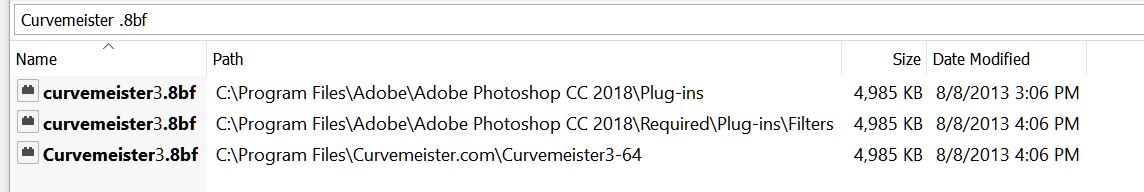

See attached jpg
Looks like I have an extra version installed? in Ps
Which one is best to disable/remove?
Doug
Doug
- Posts: 683
The one in the Curvemeister folder is the backup in case you have issues. That is the one you can copy over.
replace the copy found here:
C:\Program Files\Adobe\Adobe Photoshop CC 2018\Required\Plug-ins\Filters
The other copy should be removed.
Let me know if this does not resolve your issue.
