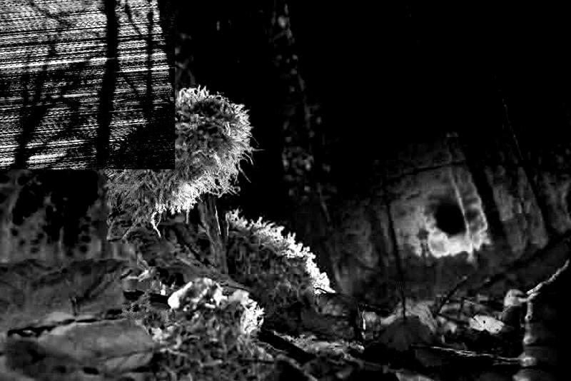

Hi, I'm having a problem by export mask from curvemeister into photoshop.
There is always these bug in the left corner as shown on the picture (hope the upload works).
And one silly question too: I don't know how to get the ribbon bar back. Klick on a wrong button ;-)
curvemeister-mask-jpg
curvemeister-mask-jpg (999 Bytes) Viewed 69316 times
Postby ggroess » Sat Mar 23, 2013 8:38 pm
Which channel is being used for the mask?
Posts: 294
Postby imported_Tanja » Sat Mar 23, 2013 8:49 pm
"b"-Channel, Greg.
Postby ggroess » Sat Mar 23, 2013 11:06 pm
Out of LAB or out of RGB?
Is this always in the same place?
what is the CM version you are currently running?

Postby imported_Tanja » Sun Mar 24, 2013 9:48 am
I don't find the arrow, but got my ribbon bar back with Ctrl + F1.
I'm comming from photoshop in RGB and use the cm-version 3.8.1.
Meanwhile I find out, that the bug only appear, when the cmyk-curves are open in cm.
It's not always the same. Now ist's much bigger, but the same place.
curvemeister-mask-2-jpg
curvemeister-mask-2-jpg (65.88 KiB) Viewed 69316 times
Postby ggroess » Sun Mar 24, 2013 1:12 pm
OK..thanks...
I'll try to repeat it and forward on to Mike Russell
Hang in there we'll  figure this out...

Postby ggroess » Tue Mar 26, 2013 1:20 pm
Well you certainly have gotten Mike's attention...
"Wow that is a Doozie"...
He's working on it...
