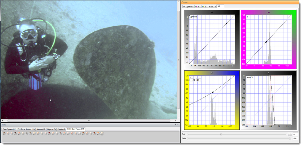

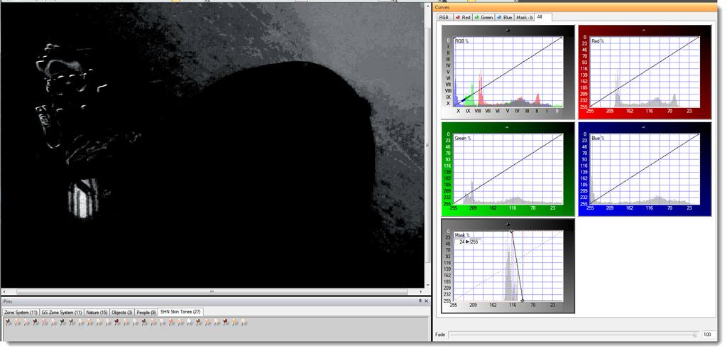

Postby ggroess » Sat Feb 16, 2013 9:12 pm
OK instead use a b channel mask from LAB and invert it. as shown in shot 1 then adjust the b channel as shown in shot 2
This is a rough version done for speed..forgive any odd artifact in the image...
greg00-jpg-5
greg00-jpg-5 (69.23 KiB) Viewed 25521 times
greg01-jpg-7
greg01-jpg-7 (291.38 KiB) Viewed 25521 times
Postby mikemeister_admin » Sat Feb 16, 2013 9:47 pm
Impressed with result, could you explain that step a bit more?
