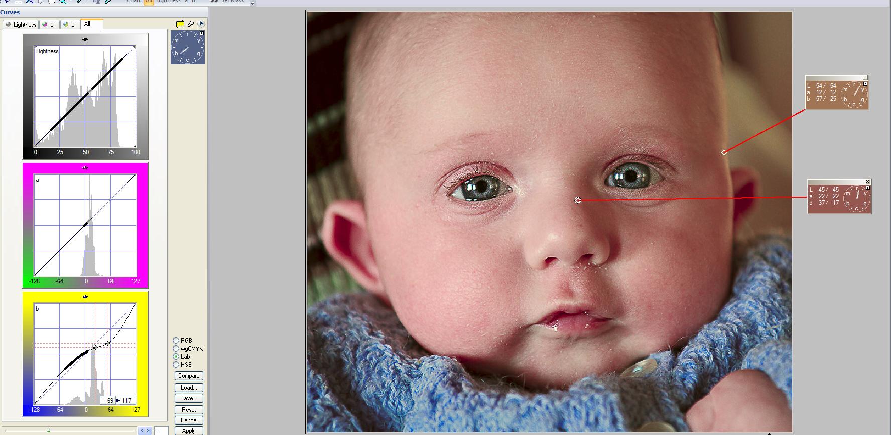

I loaded an image with a colour cast and was playing a bit. I was thinking that we often drive colours appart in an image to make it look better, like foliage for instance.
A cross colour cast, like the picture, where the intensity of the cast change from side of face to middle part, is actually the opposite of what we want to do with driving colours appart, here we could get rid of the cast by  selecting the two points on my curve, one in the sronger and one in the weaker part of the cast. If I rotate the  curve (in ie the b channel) clockwise, to flatten that part, I then unstretch the cast. I then "lowered" both to get rid of yellow. Hope I make sense and do you agree? This took me 15 seconds to do

That certainly should work.I've never tried it..It might make a bigger mess of things.....Also remember to set the anchor point so you can move the curve back to the starting values...

Dynamite, Ganna!  Looks much better.
