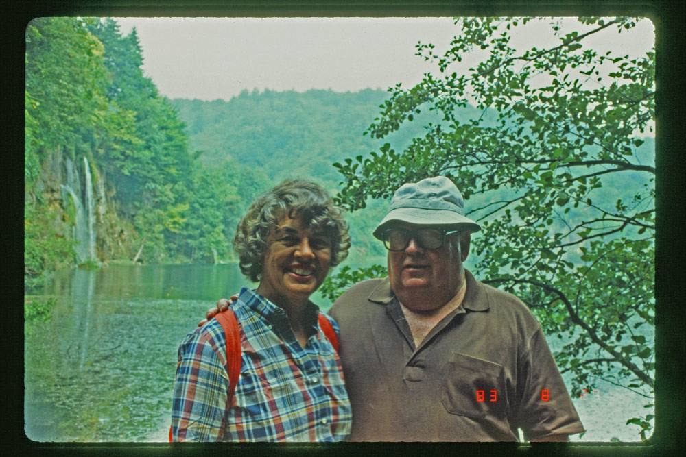

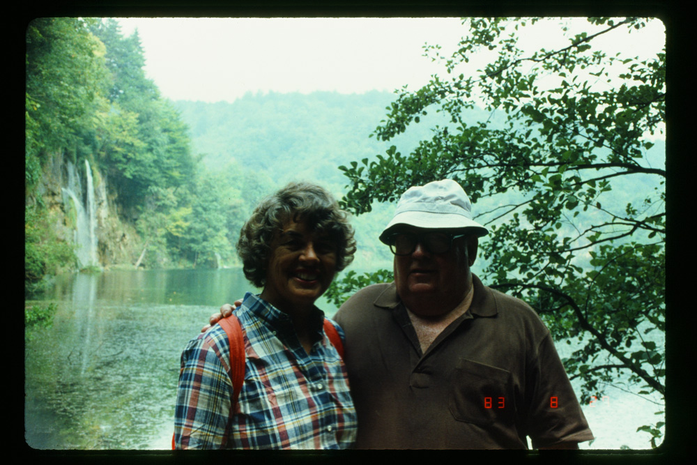

Here is an image to play with. A slide from 1983 of my parents. Image 2 is the same image with highlight shadows. Image 3 is much more work with masks and hdr.
Image 3 is okay, I wish it were better and faster.

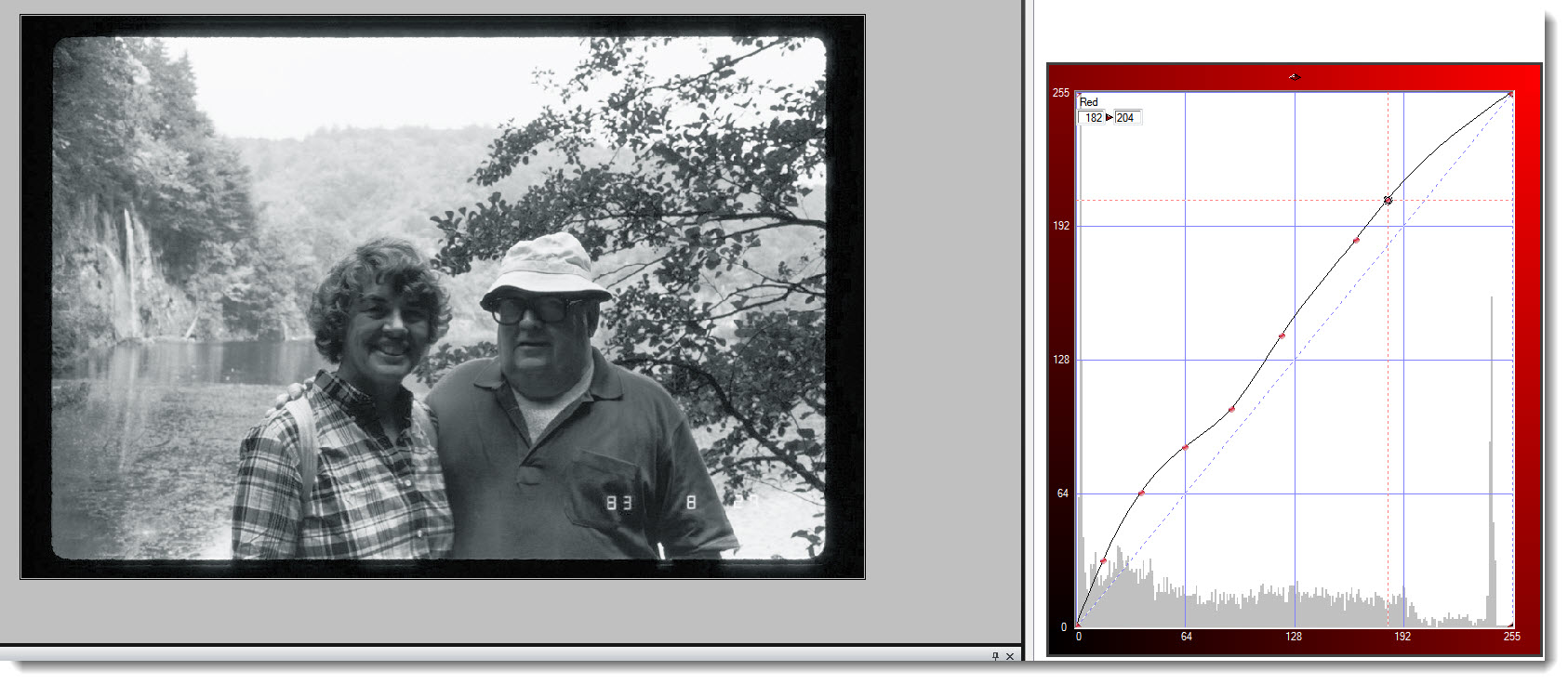

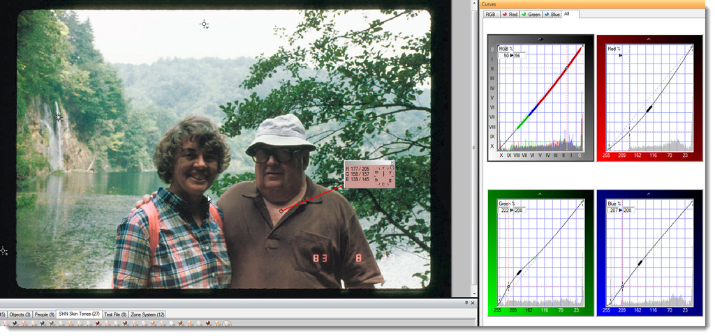

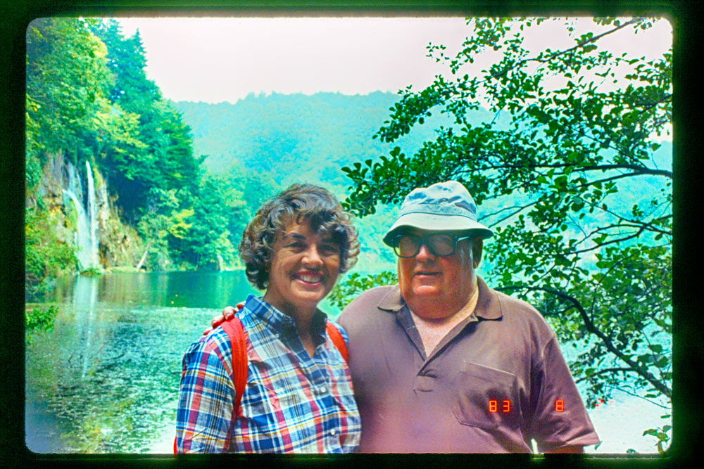

1) copy the background layer to a new layer and switch to channels on the new layer. I looked at each channel in RGB and foound the Green and Blue to be worthless for contrast. I curves the red channel as shown in shot 0 and applied it to the other two channels Image>Apply Image...(Normal mode) this makes a B&W image on the layer since all three channels are now identical to the curved red channel. Switch back to layers and change the mode to Luminosity.
2) I curved it for the skin tones in RGB and then added a neutral to the waterfall in the background. Since you have the slide frame as a part of the image I used it as the shadow point and the blow out sky was the highlight. Shot 1
So far this is less than 3 minutes of actual work...it took more time to figure this out than it did to apply it...
Lastly, I did try Shadows and Highlights in PS to the image after getting the color closer and the tones in a better place...It comes down to personal taste after the RGB pass for color.
