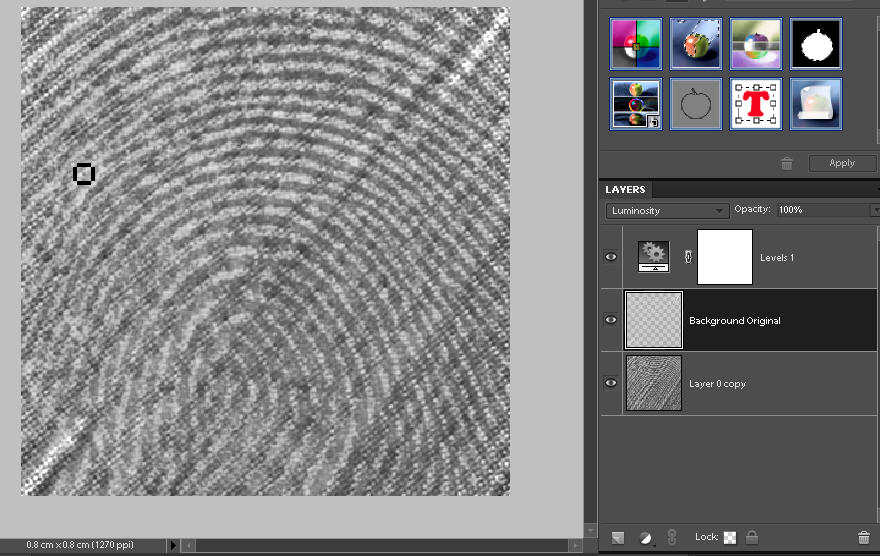

Thanks Greg. Please let me know if the screenshots are correct.

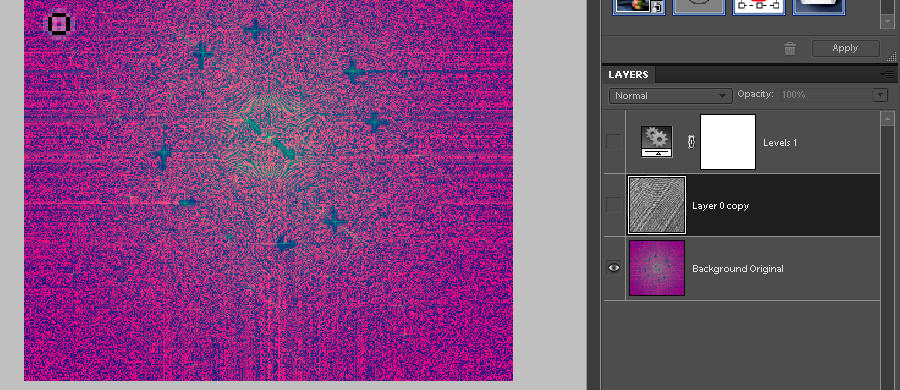

Screenhot 1. Painting out the stars on the FFT image with a Cyan brush set to multiply.
Screenhot 2. Geting a faded looking result after using inverse FFT
Screenshot 3. After using inverse FFT Putting the resulting very faded image on top of the original background layer and setting blend mode to luminosity. There is some improvement but there are still imperfections there.
Which layer in the screensot am I supposed to apply Gausian blur to? Layer 0 Copy or Background original?

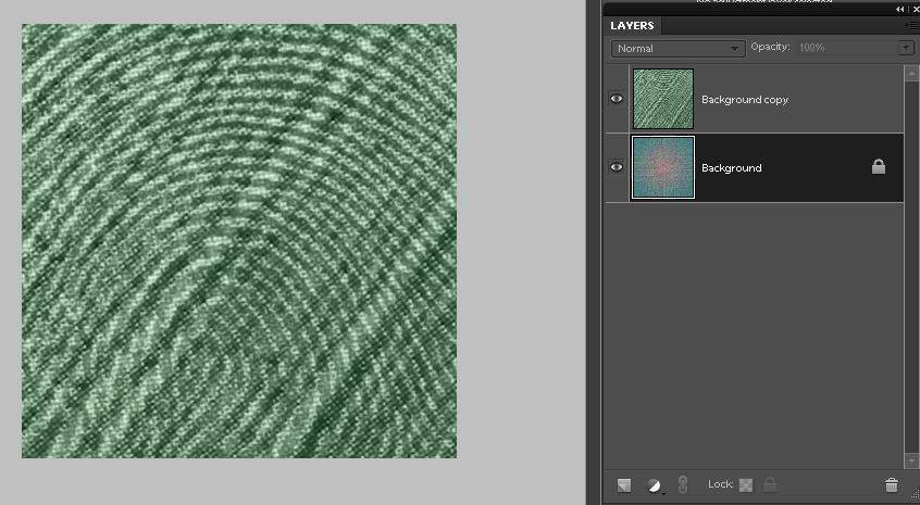

3 For the sake of the demonstration I Introduced a green tint to the test file. Right click the original background and select duplicate layer. Please see Screenshot 1

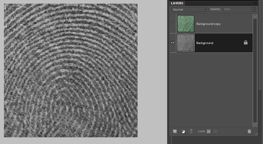

4 Go to filters and under "Fourier Transform", apply the FFT filter to the original Backgroud layer on the bottom. Note FFT does not work on a true layer so thats why it has to be applied to the original Background which has no transparency information. It will not work on the copy above it which is a true layer. Please see Screenshot 2.

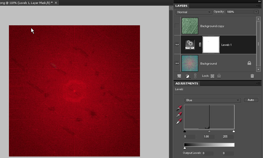

5 Apply a levels adjustment to the Background layer and as Mike says select the blue channel from te drop down menu and drag the output slider on the bottom right all the way to the far left so the blue output level is set to zero. Do the same with the Green output slider. The result of the FFT image will look red. Please see Screenshot 3.
6 Click the foreground colour box and select Cyan by typing R 0, B 255, G 255. Select the brush tool and set the brush mode to multiply from the top menu and carefully paint out the stars and diagonal lines but leave the central point of light intact. Please see Screenshot 3 and also the link below for more details on the parts to paint out.

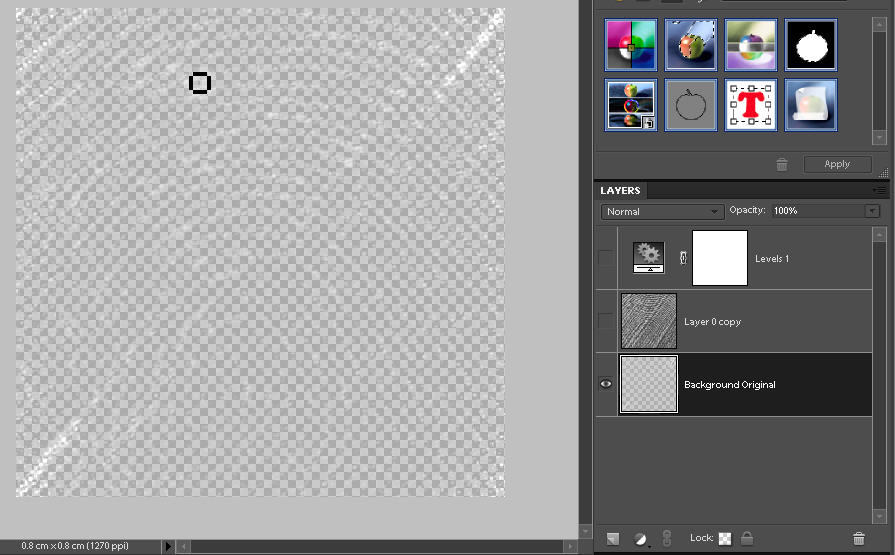

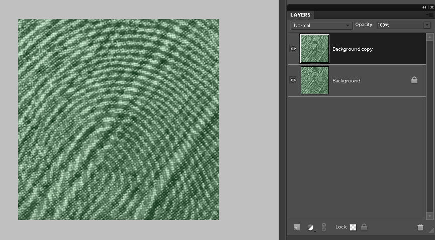

7 Click on the origial background layer and apply inverse Fourier Transform iFFT. The resulting Image will look red. Later you can delete the layers adjustment. Please see Screenshot 4 and also screensot 5 with the layers adjustment deleted.

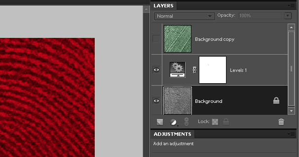

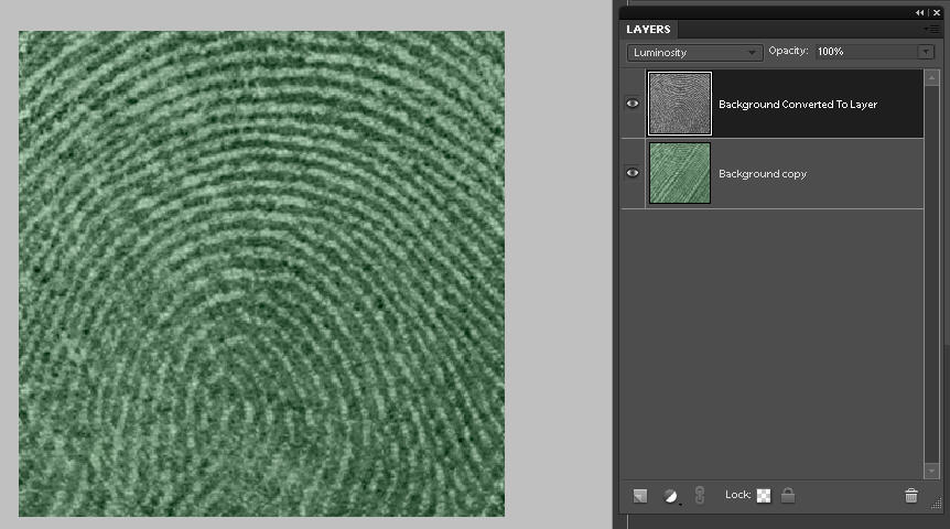

8 The problem at this point is the image has lost its colour due to the FFT. If it was originally a black and white image we could leave it as it is. However to bring back the colour in a coloured image another step is needed. Right click the original background layer to which FFT and iFFT has been applied and right click and convert to a layer. Then move the black and white image over the copy of the original image (Green) which still has its colour. Set the blend mode to luminosiy and switch on all the eyes. The colour has now returned. As a finishing touch apply a Gaussian blur of about 2 to the lower coloured image. (Filter/Blur/Gaussian Blur) This will not blur the resulting image because the details come from the image on top and the lower image just provides the colour when the blend mode is set to luminosity. Please see Screenshot 6.
I wish to thank Mike and Greg for helping me to understand this very useful technique and of course Alex Chirokov and the site www.4N6site.com for providing the FFT plug in. If I have made any mistakes in the desription please let me know. I wanted to write out all the details with screenshots in case any other Photoshop Elements users wish to try it out.
