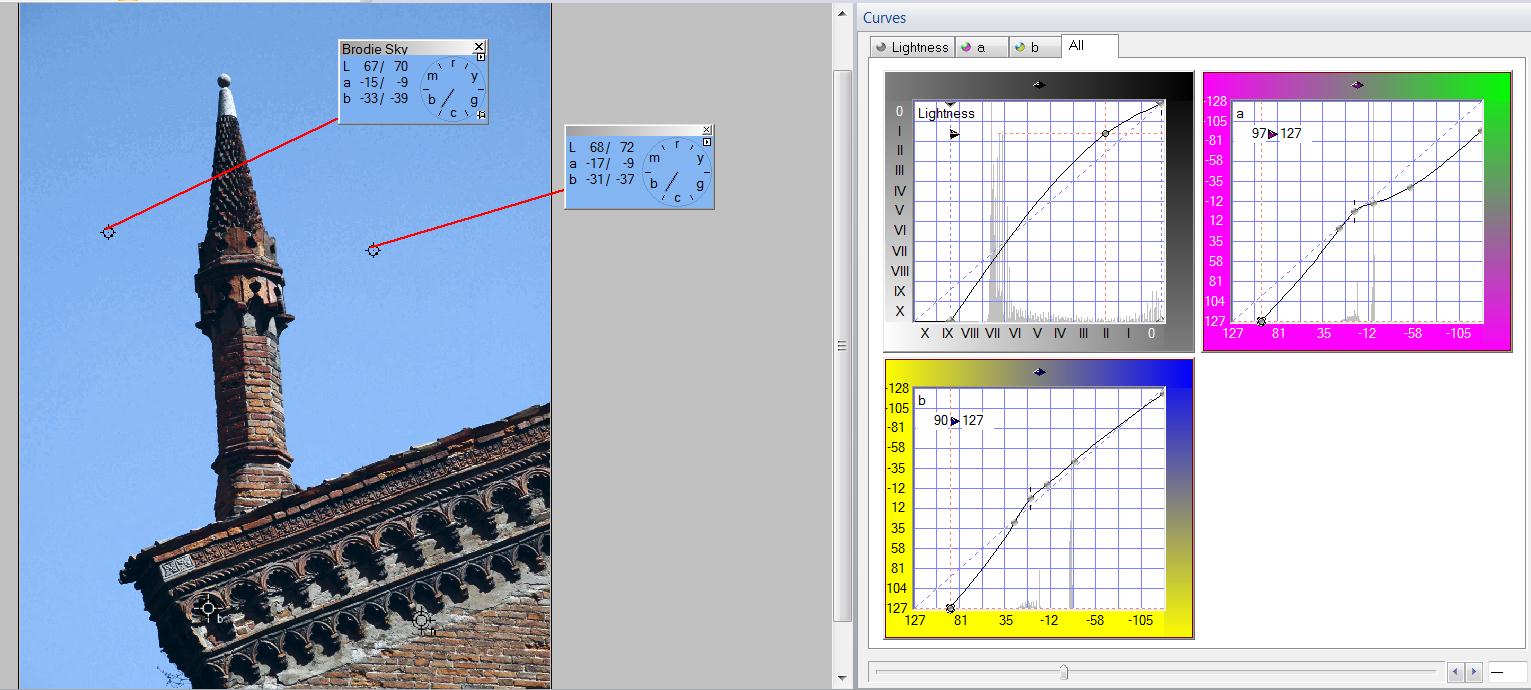

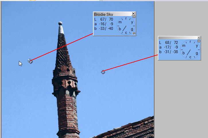

In Shot 2 you see the gelnco sky pin so that you can see a reference color for the sky. In shot 3 you can see my settings to get your sky back to the range of the Glenco sky pin. I did a bit more to bring the yellows back to the bricks and I upped the saturation slider a bit after the color was better....
