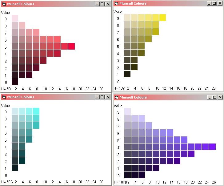

Your screenshot is very interesting Chris. I hope that you will be able to answer a few questions that I have about it:
  • Your Munsell step wedge is divided into 11 segments, whereas the Lab version has only been divided into 9 segments. Why is there this disparity?
  • Your Munsell values don't appear to follow the shape of the 5R colour swatch. It looks as though you have derived values between 0/0.7 and 10/7.3 along a straight line. The Munsell swatches show that chroma (saturation) should be highest at value 6; in your step wedge it's highest at value 10, and then it gets progressively lower. Why is that? I'm wondering if the Lab step wedge looks more realistic because the Munsell step wedge is not respecting the shape of the 5R colour swatches; am I missing something?

1. The Munsell Saturation ruler is in 11 equal segments in steps of 10 L (0 to 100).  The Zone System Ruler follows the system defined by Norman Koren (http://www.normankoren.com/zonesystem.html) which I believe is more in line with the idea of the Adam's Zone system, than equal segments, for digital images and has less segments than the original 0 - X.

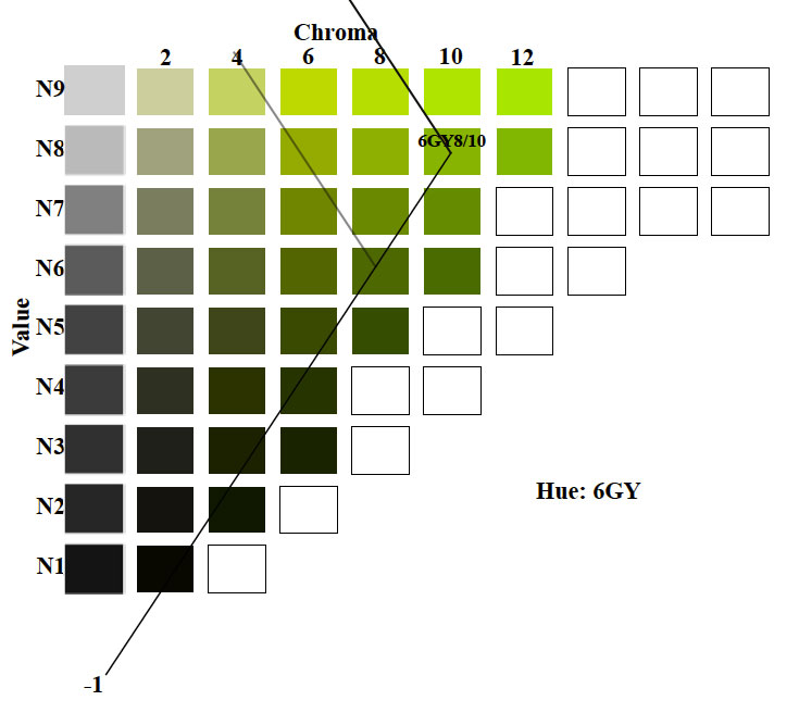

Suppose that the colour when lit has Munsell coordinates H V/C
For example 10GY 7/12.  The left axis is a vertical line of neutral greys, numbered from N1 through N9. Continue the neutral axis downward, to where the value would be -1.
Draw a line from the value -1 on the neutral axis, to the center of the square containing 10GY 7/12.
The shadow colours of 10GY 7/12 fall on this line.

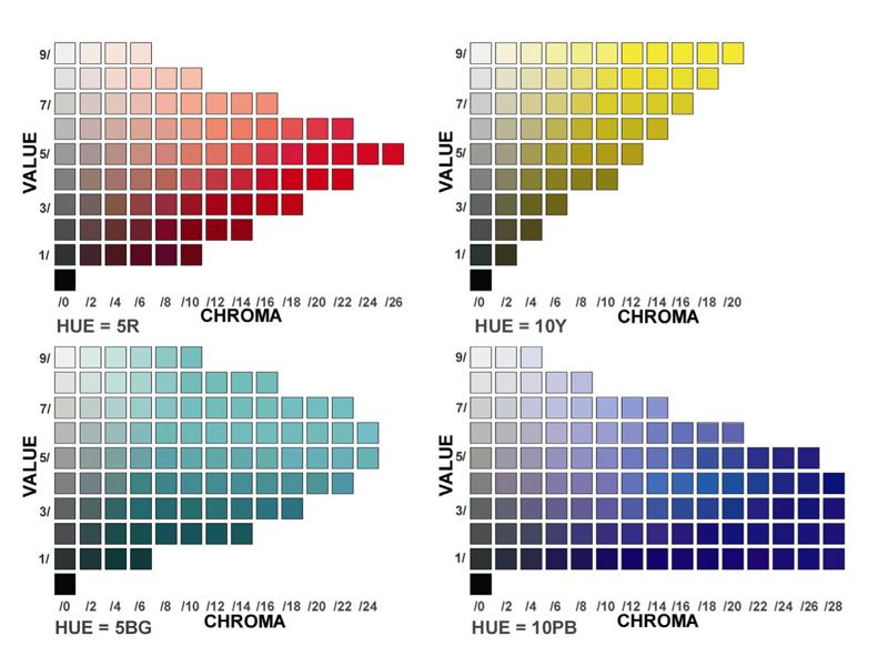

Frank Reilly's advice seems to conflict with the Munsell system; either that or I'm getting in a muddle. I've attached an image that I found online. It demonstrates that chroma should not decrease in relation to value for all colours. As we can see, if we are dealing with yellow, chroma decreases with value, but if we look at blue (10PB), chroma increases as value decreases, and for red chroma first increases, and then decreases.
Am I missing something?

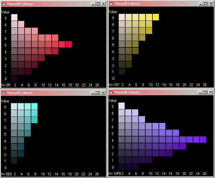

The images you picked up is not correct and show a lot of out-of-gamut colours
I think the attached (in gamut only colours - on 2 backgrounds) are more like it - but I think you are not using the Munsell terms correctly (http://en.wikipedia.org/wiki/Munsell_color_system)

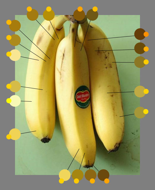

Calculating the saturation level (chroma) of brighter tones by continuing along the Centore line would result in saturation increasing in areas brighter than the local colour of the object in question - whereas saturation actually decreases (see the attached images of the flags - borrowed from: http://www.lloydgodman.net/tech/tech/Exposure/saturation1.html, and also the attached image of the bananas - borrowed from: http://www.wetcanvas.com/forums/showthread.php?t=928132&page=2).
This decrease in saturation suggests that if Centore's line is to be respected for tones brighter than an object's local value, it needs to be flipped - giving us a Centore/Reilly boomerang (see my doctored version of one of Paul Centore's images).

BTW I believe that Yellow and Blue are bad colours to pick because of out-of-gamut problems.  Remember as Yellow gets brighter there is more Blue in it (RGB) which is clearly wrong!
