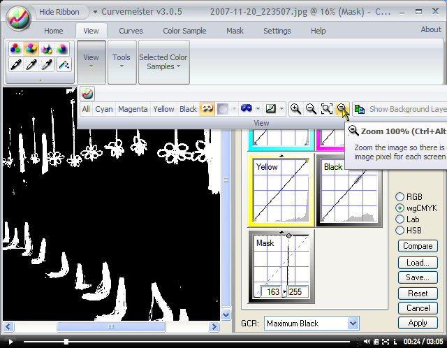

Start by zooming to 100 percent.
The hints for this example provide a complete description of how to mask the red tassles and change them to a black color. So I'll just show a couple of finer points to help you get around two common pitfalls with masking. Start by zooming the image to 100 percent, so that we can get a good look at any glitches.

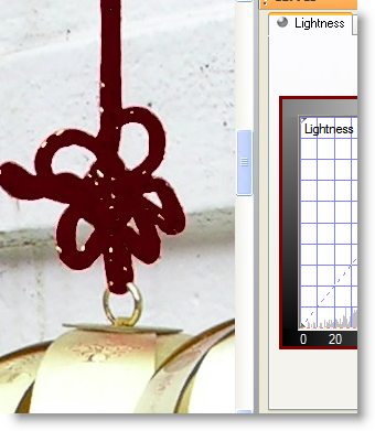

The first glitch is pretty substantial. Although I've moved the lightness curve to get as dark a result as possible, the braided cord still has some of its original red color. Not good.

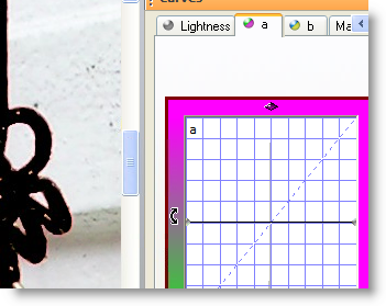

The fix is simple - select the a curve, and make it flat. Voila! We've got a nice solid black.
In some cases - not this one - you may want to flatten out the b channel to get rid of any blue or yellow tint.
