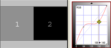

This example is a combination of two earlier examples, and the first example where we need to get into curves that are not straight lines.
We want to make both the numbers as clear as possible, so we use a compormise curve that is steep on the ends, and level in the middle. This works because there is no middle gray in this image.
Is there a way to make the 1 and 2 stand out even more clearly - let's check out the next example
